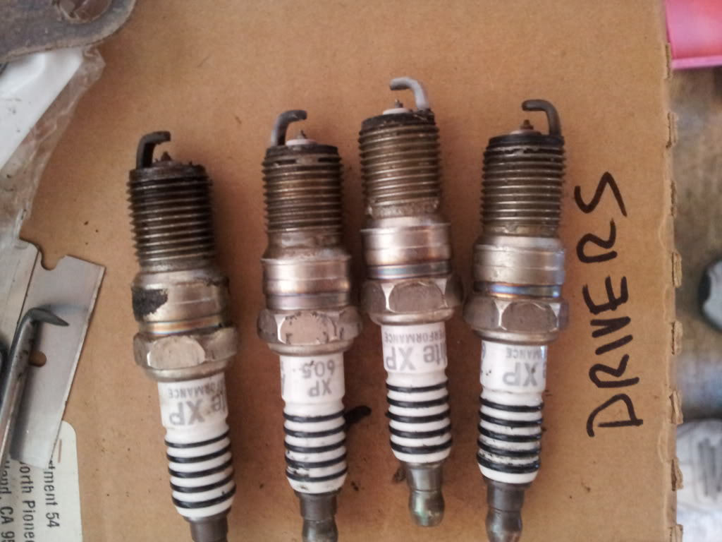

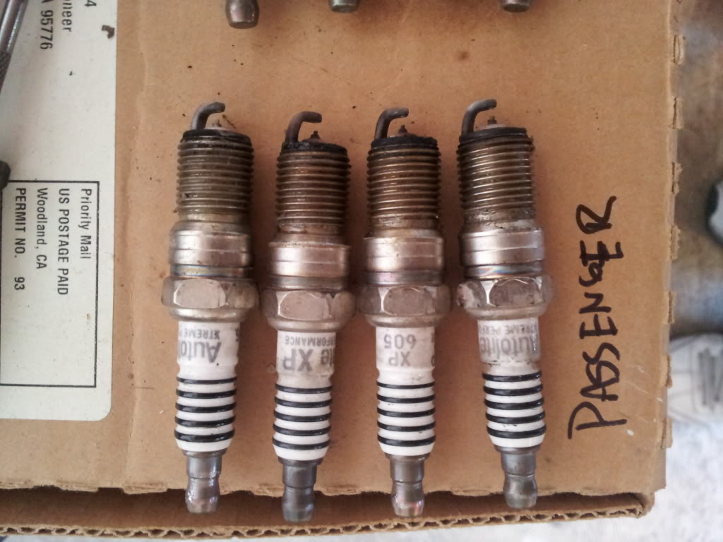

Plugs are shown fwd to aft as removed. Reading you mean in ohms? I did a couple and got 6.4 on 2 and 6.1 on another. Tomorrow when I get home I can read the rest if that is what you meant.

Reading as just as I am doing now. Overall not to bad 1 and 4 look a little extra carbon-ed and number 3 looks a bit lean but not real bad at all. Try checking out your ignition coil using the test below. Also check your grounds on the thermostat housing and right fender well near battery as well as pump ground on the left frame well for cleanliness.
