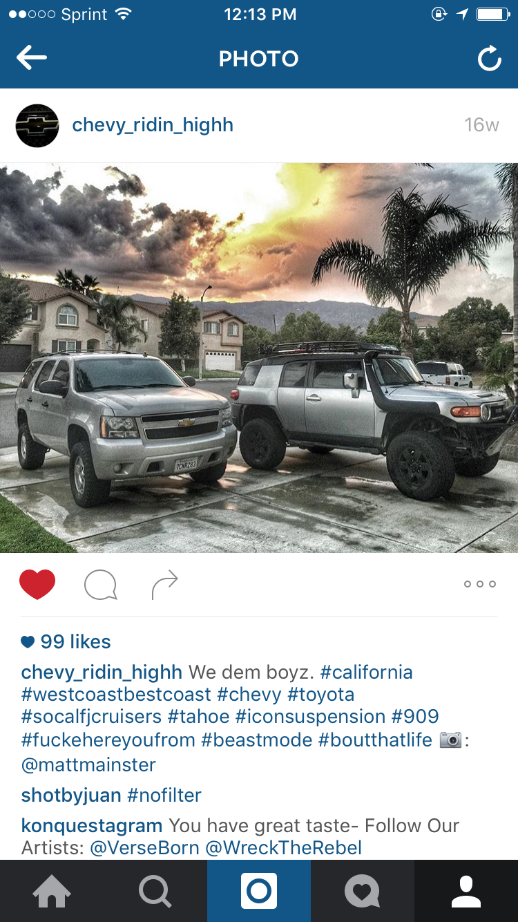

Nice. FJ isn't mine it's a buddies. He actually started the So Cal FJ Cruiser forums not sure if you are familiar with them.
Most of my friends drive toyotas/fjs but I love my Tahoe.
Do you go to the desert down there or take it offroad? If so, take a look at ICON coilovers (not sure what the RC 3.5" consists of, so not sure if they are compatible). I have that on the FJ and they are great. If we keep the Tahoe I will replace the suspension with ICONs.
Yeah I have been on the So Cal FJ forum. There is another FJ forum that has more traffic and includes all regions so I am on that one.
