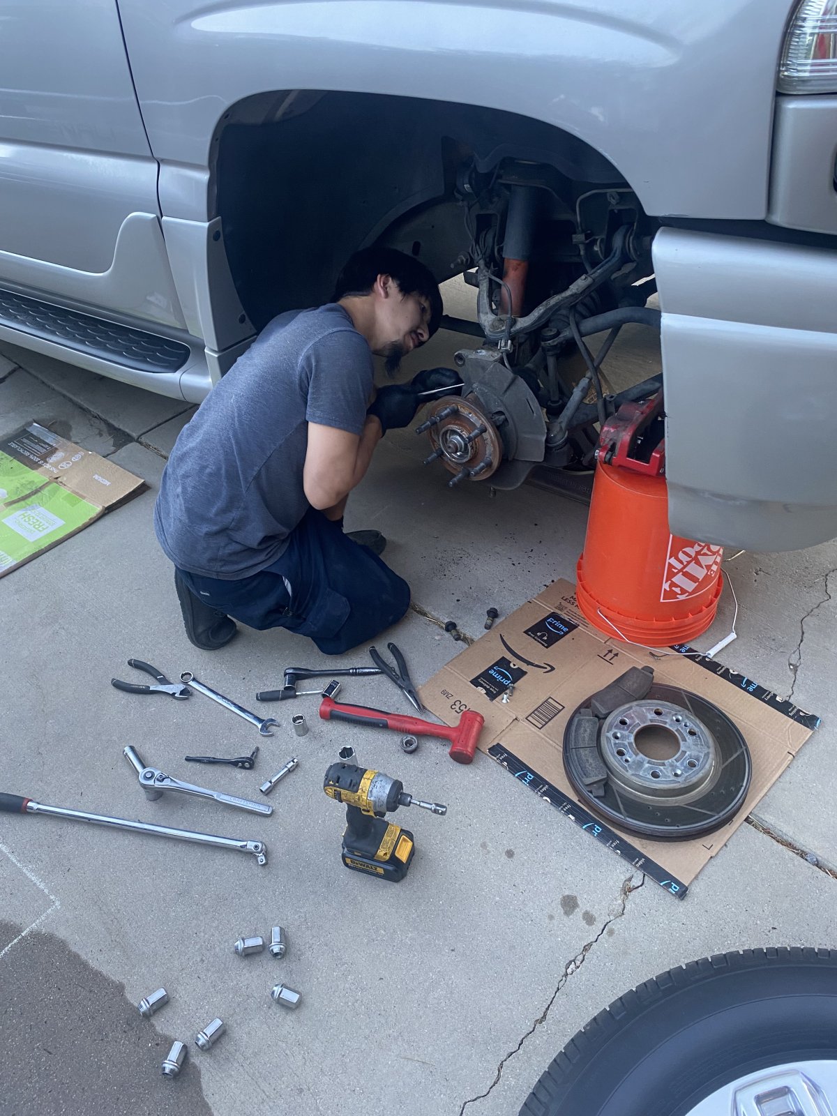

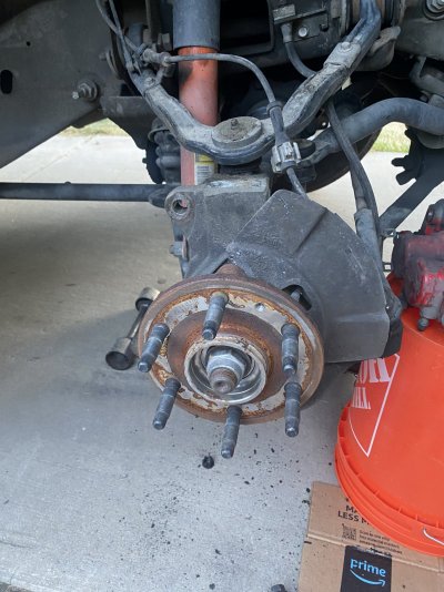

But had to go on an adventure tonight I definitely did NOT want to go on….. ooi…. Trucks had an odd rattling noise that I thought may have been coming from one of my brakes. It may well have been making noise before I put new pads in last week, I just hadn’t noticed it until the last few days. I re did all the retainer clips in the brakes but didn’t have time to go further. Well I decided to ask Bryce if he’d check it out for me real quick tonight after we had dinner. I sorta felt a bit bad asking because he had to work all day. He’s an A&P mechanic for skywest, definitely works his keister off. But he’s a gearhead through and through and he’s a dang good mechanic. Knows what he’s doing working on cars AND planes. I fully trust him. Anyways we went for a quick ride around the bock and he knew right away that the noise was coming out of my front passenger side wheel. It actually got WAY worse today. I was like “oh crap…. That’s bad…“
Jacked it up, wheel off, brakes are all good…. Buuuuut turns out I had a bad wheel bearing….. like really bad…. Put a mild groove in my rotor from the play in wheel and caliper movement…. D-A-M-M-I-T……. I replaced that wheel hub only two years ago….. and of course the part I’d bought from autozone only had a one year warranty on it…. :banghead: So we had to put a new wheel bearing in. Sucks cuz I know thats not how Bryce wanted to spend the evening. But he’s a good guy and because I’m heading home tomorrow his exact words were “I’m not letting you drive out of the driveway like this cuz you won’t make it home….” So we ran over to autozone and thankfully they had a new part in stock and he had the job hammered out in like all of an hour…. I’m thankful for friends that look out for me even if I don’t want to put any extra stress on them. Solved the issue and trucks is ready to roll home tomorrow.

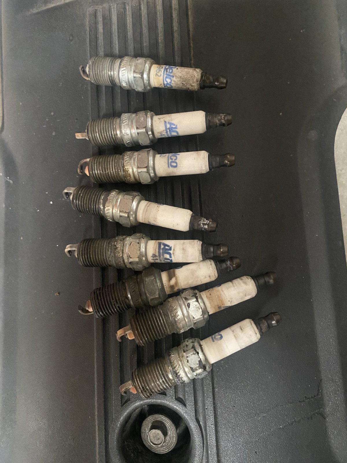

Finally got time to do spark plugs. I’m not gonna lie…… I swore…. ALOT!!! The drivers side, odd numbered cylinder plugs absolutely sucked. I was constantly slamming my hands into everything in the way on the drivers side. The #8 cylinder on the opposite side of the block was WAY easier than the #1 cylinder….. it was so dang difficult to get my hands in there under the battery fuse and all the other hoses and wire looms running beside the block….. I don’t understand how mechanics do it for a living everyday…. lol
50,000 miles on these plugs. Not terrible I guess but not pretty either haha.

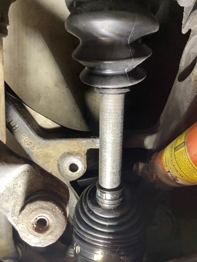

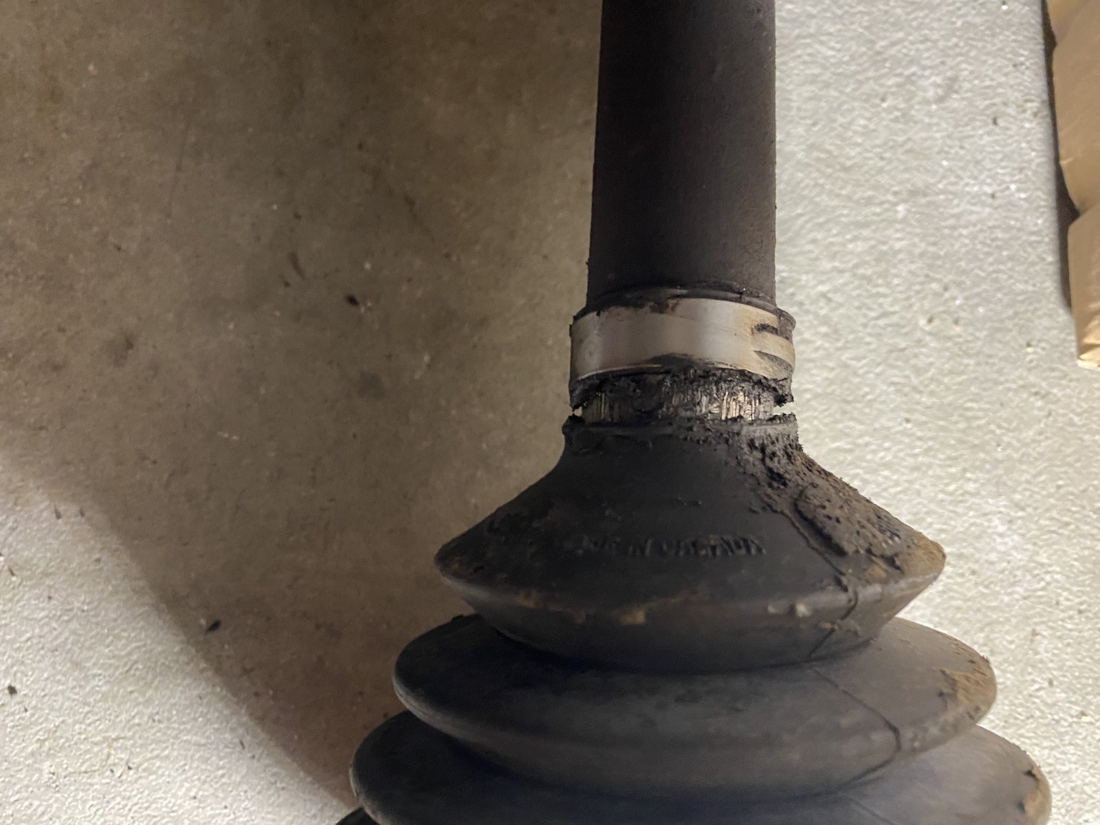

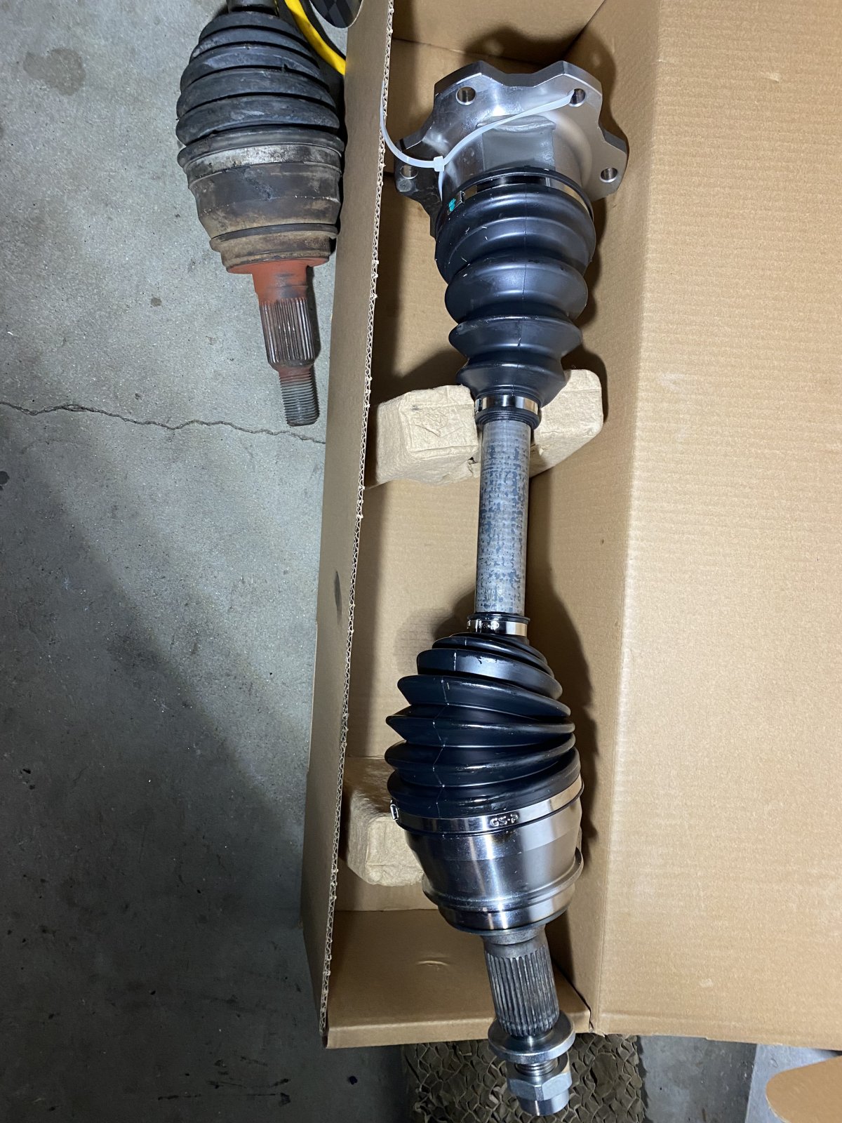

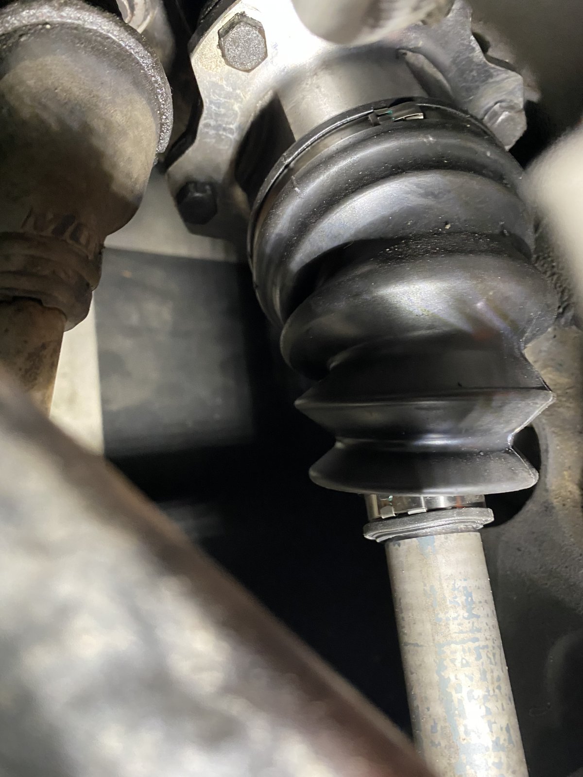

so life has been a trip lately. I’ve managed to make good friends with the general manager of our local autozone. It just so happens that he and his wife go to my church. Really cool dude and very knowledgeable. I was asking him for some advice about replacing a torn CV boot, on the drivers side CV axle, and his suggestion to skip the hassle of taking the entire CV axle shaft out just to have to disassemble it and reassemble with a new boot and just grab a new axle shaft to put in with the boots already installed made so much more sense. So I went that route and glad I did. I was thinking since I had to be in there anyways I may as well replace the drivers side wheel bearing as a preemptive maintenance item. The second benefit to buddy buddy up with the GM of my local autozone is that when I was telling him about the plans and being really annoyed that my first wheel bearing replacement only lasted two years, he said “bring me the bad wheel bearing and I’ll refund it with store credit and we’ll use that to get you another wheel bearing.” So that didn’t cost me extra, and he sold me the axle shaft for a discount too. That helped big time. Replaced the axle shaft and the wheel bearing and got both done on my own fairly easily. I was definitely proud of myself for getting it done without having to ask for help or running into problems.

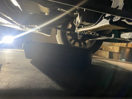

Been sitting on 2 quarts of trans fluid to service my transfer case for like 3 weeks now…… transfer case service was WAY overdue….. thanks to a MASSIVE forest fire burning around my mountain right now I had the day off today due to the far west end of the big bear valley being under evacuation orders. Had time to hammer out the transfer case fluid swap and got it handled along with putting fresh chemical resin into my deionized water tanks for my detail setup.
Surprisingly easy to swap fluid in the transfer case out. Got the drain plug back in and filled up. Rolled perfectly fine to the convention center tonight for my dance teach night. The fluid that came out though was pretty icky……
