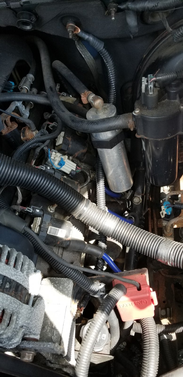

I also uploaded some pics I found on the web so you can see what's behind the engine. You really can't take these off and put a brush to all the connections and put them back on.

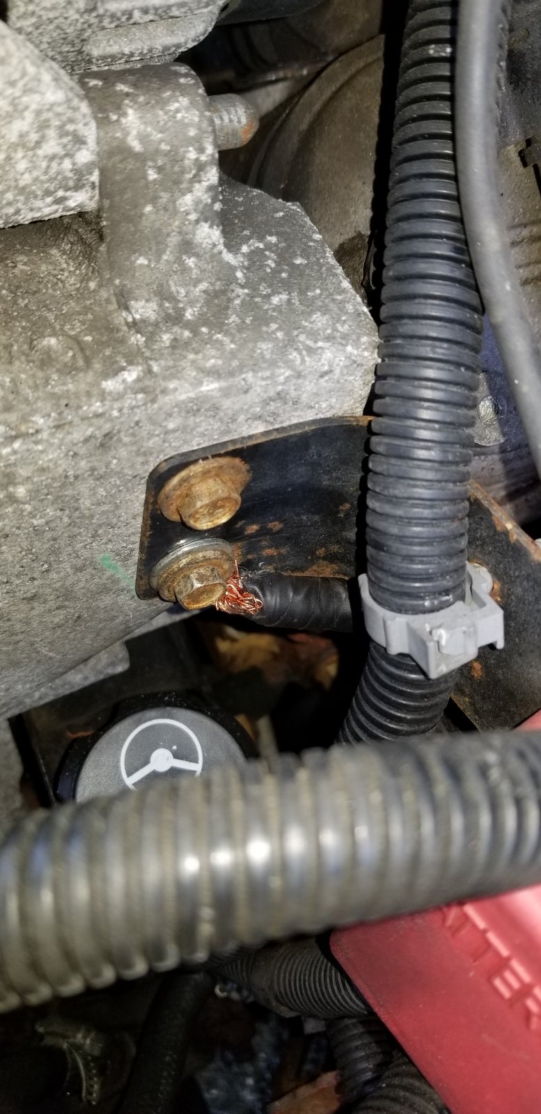

Here is a couple of pics so you can see what it looks like behind the engine...

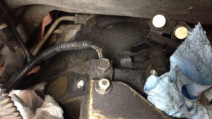

Here is another video for the passenger side ground shown directly above. This one you can reach with your hand so once you loosen it with a socket wrench you can back it out with your hand and screw it back on when ready.... Once you remove it, use a brush to the engine block. You can reach back there and do this. Then you can put the bolt back on but you can go one step further. Check it out. Not the best video but it works.
