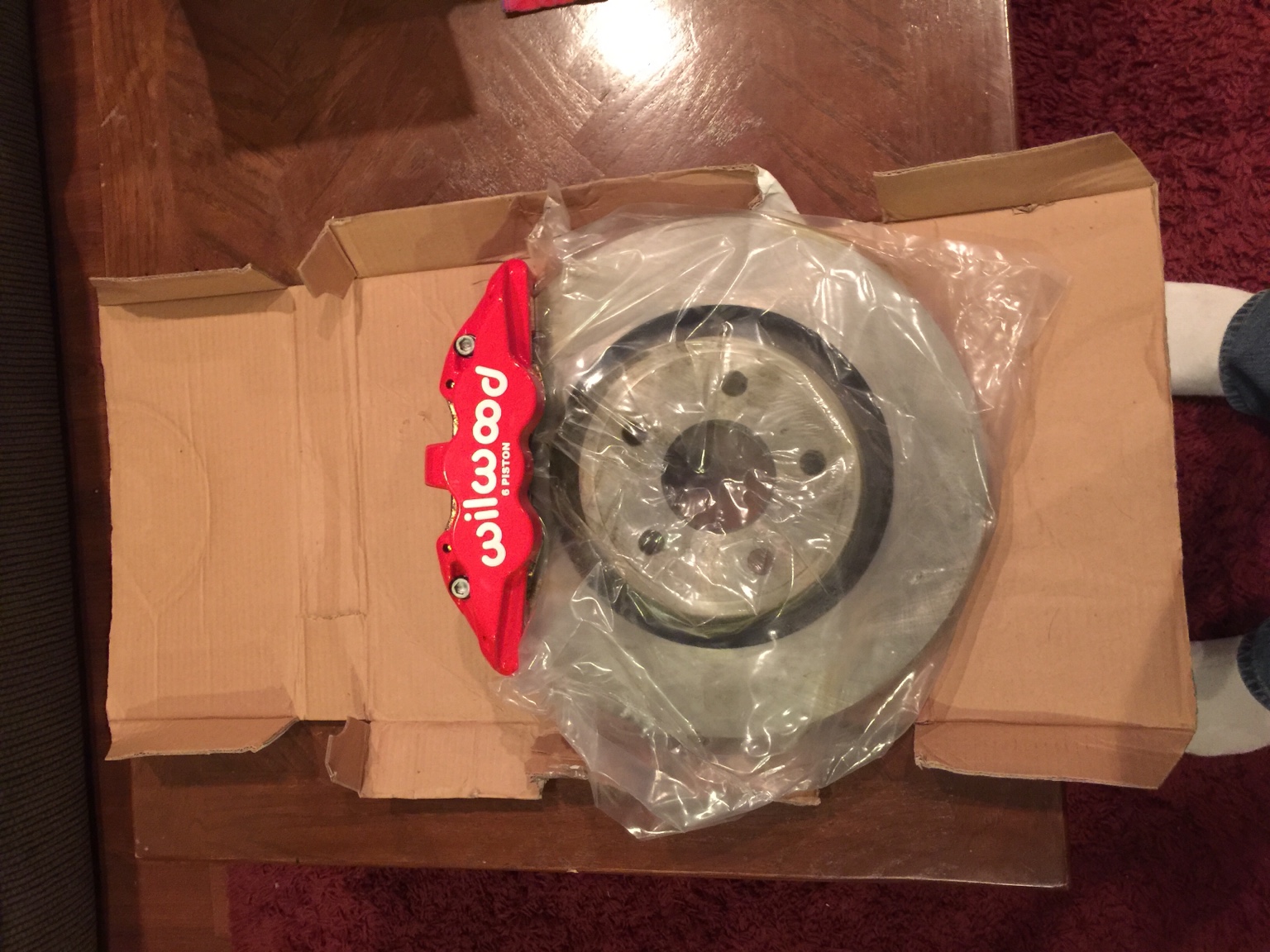

Ok so if you have looked for brake upgrades for the OBS Chevys you know that hydroboost with a NBS master cylinder is the most cost effective bang for you buck. SSBC offer a 13" rotor/caliper upgrade kit but for $2.4k yikes. I bought my Hoe for $600. Well after much research and measuring I think I have it dialed. Granted I'm using Jeep rotors but yes it's going to be what is needed for this 5k lb family mover. So I have 6 piston Wilwood calipers that is a upgrade kit for a newer Z06 that will bite on SRT8 Jeep Cherokee rotors up front. The rotors are 380mm (14.96") and 5x5 bolt pattern. I'm converting the stock 2wd rotor into a hub and will float the rotor over it. Obviously I'm going to have to have the bracket cut so that's tomorrow's project. The rear will be SRT8 rear rotors 360mm (14.17") and I'm using a pair of Brembo front calipers from a G8/SS or SRT charger/challenger will work. I'm going to do my cardboard template magic tomorrow and off to the water torch. Pics to come. I'm waiting on my remote start to be finished.

Here is the front mock up. I had my measurements off the front rotors are actually 360mm and the rears are 350mm. Still a lot of surface area. These are just mock rotors as I will be getting some drilled and slotted rotors. The front has some untouched rotor that the pads won't hit but it's not much. Rear calipers will be here Friday and I'll get that going. I will post pics of the caliper brackets tomorrow

Well after doing some mock up I think it will work just fine. This is for a 2wd but I'm sure you could redrill the rotors and make it work. I just received the rear calipers today and I just ordered the drilled and slotted rotors. Will post new soon.
