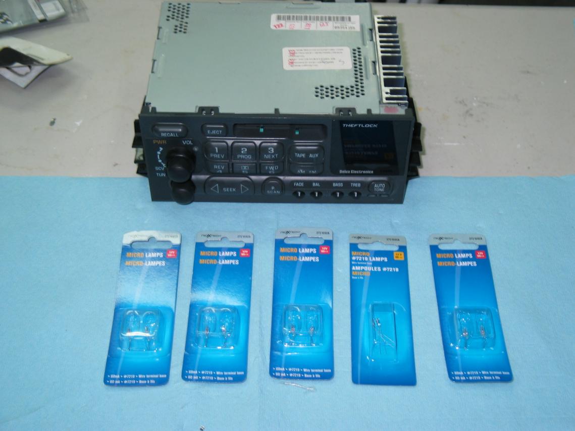

[Or, you can just do it yourself!
Radio out with new bulbs:

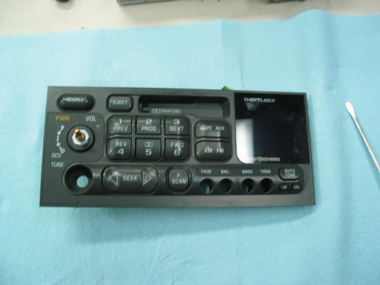

Faceplate off:

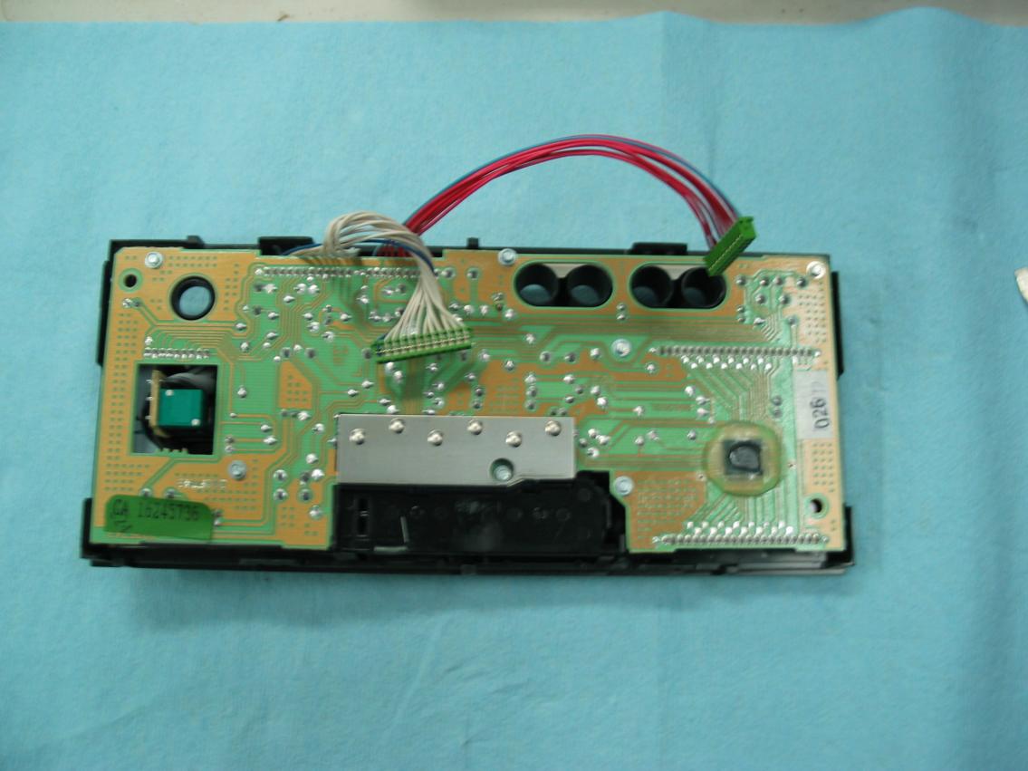

Back of plate, removing screws:

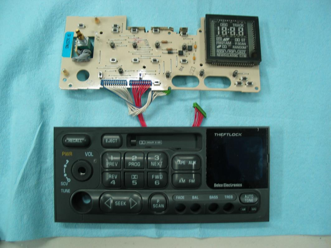

We have separation!

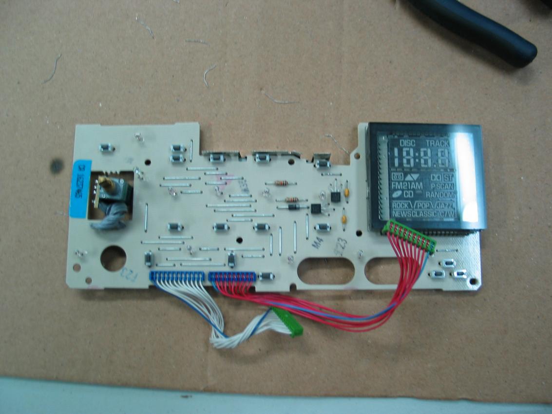

New bulbs soldered in, ready to re-assemble:

where are the bulbs soldered? you think i could do this and swap em for leds to match my blue leds elsewhere in the interior?
They are soldered through the panel, you just have to heat up the old solder to pull them out. Stick the new ones through and re-solder. I think you could totally replace them with blue led's, not sure where you could find the solder-in type though.
