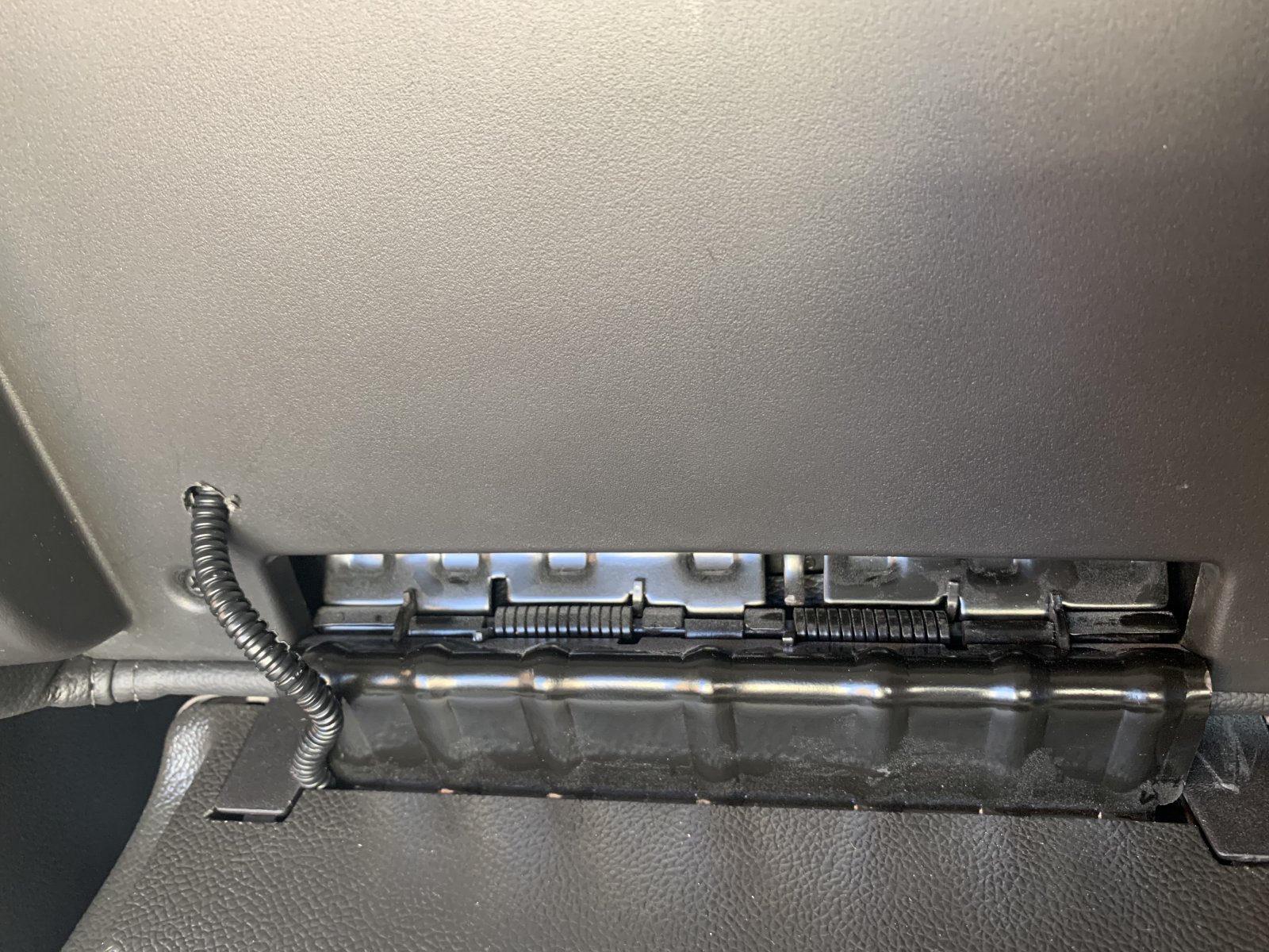

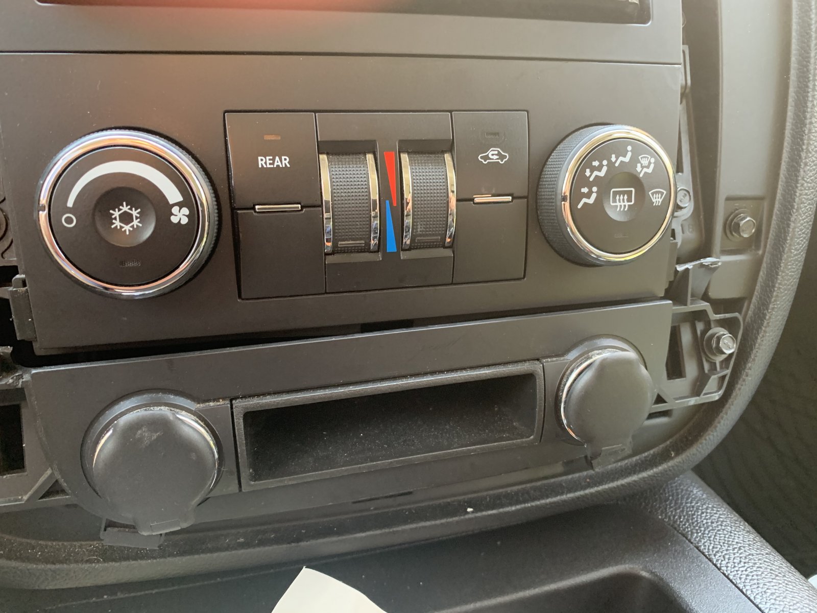

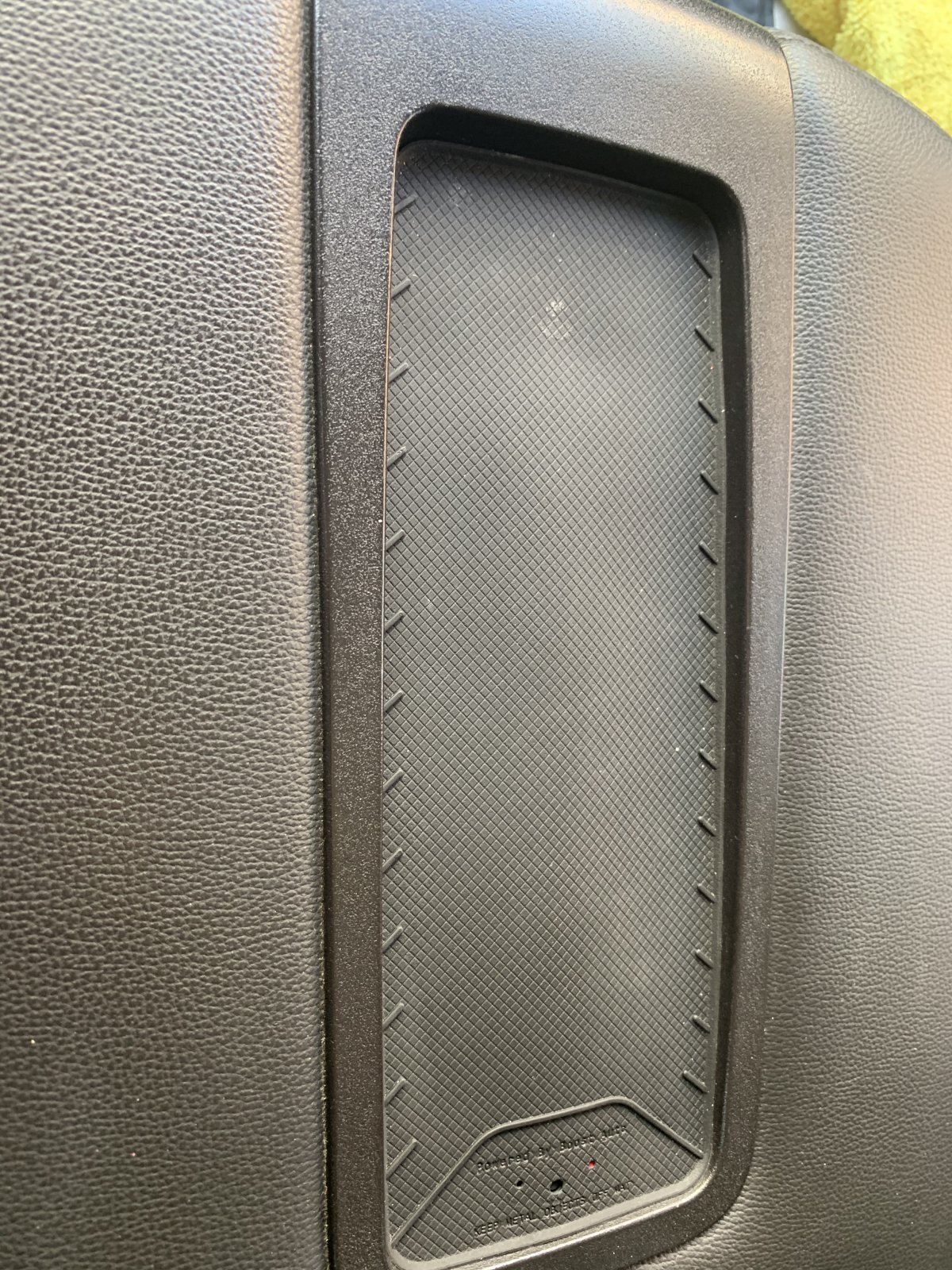

To all that are looking to add a slick wireless phone charger that looks like the 2015-2020 models, I found the solution.
Boostautoparts.com has a great solution.

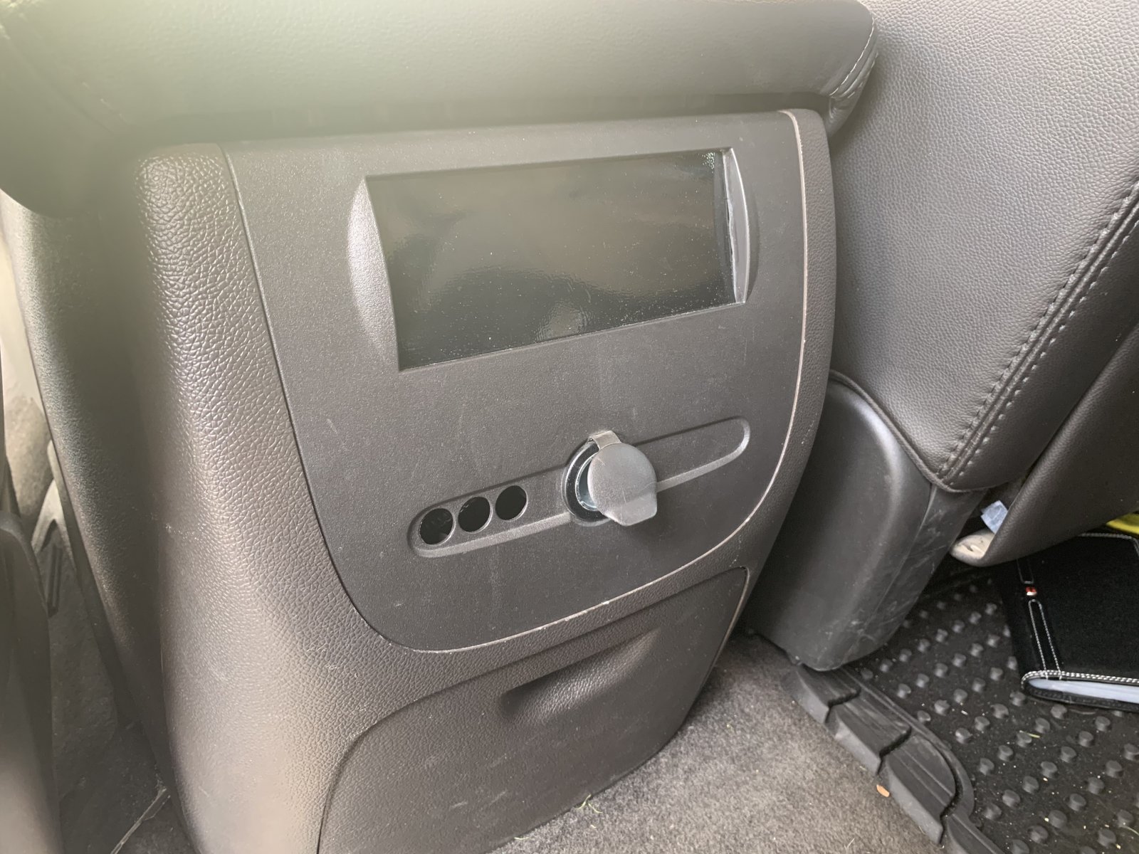

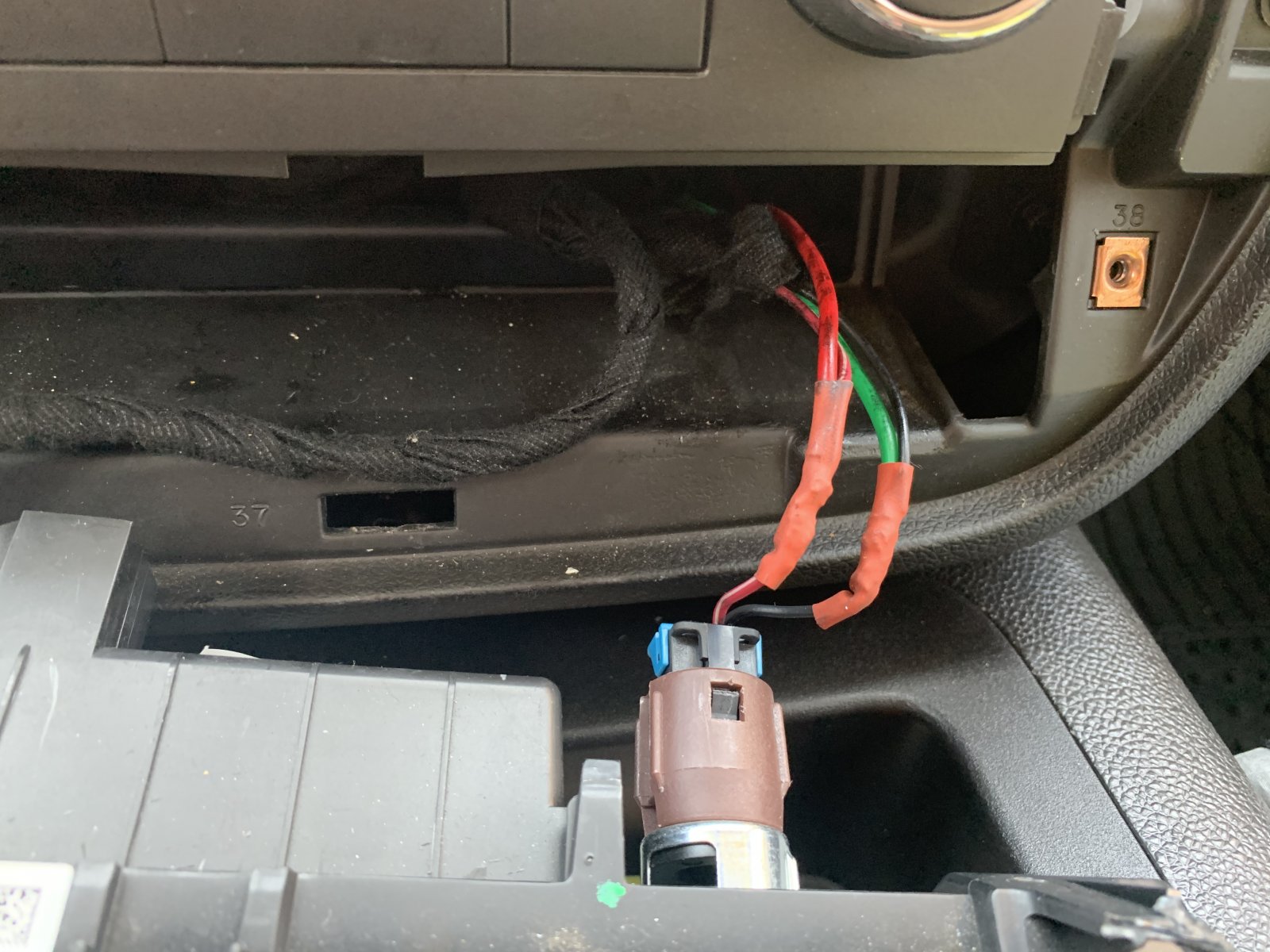

now, unlike the civilian models, you will need to find a center console and add some power. I tapped into one of the two front cigarette lighters and ran my own wires to the rear cigarette lighter on the center console. This will follow the install instructions.
love this charger and upgraded my stereo headunit to a new Kenwood that has wireless Apple CarPlay and Android Auto. Feels like a new truck.
