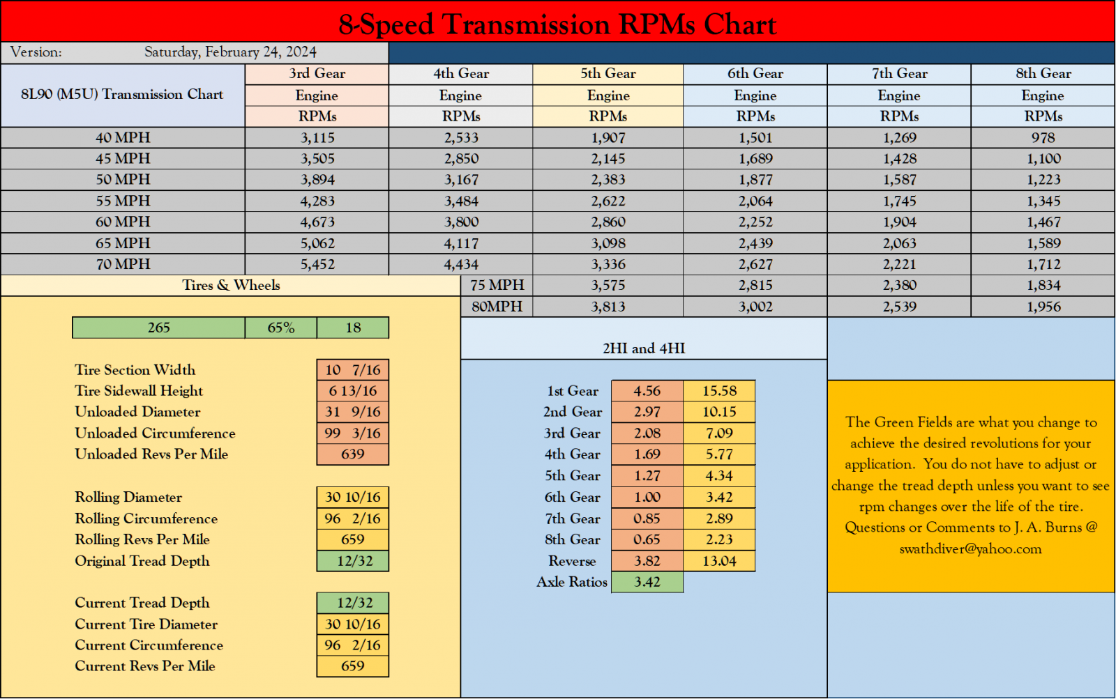

Here are some examples of what your effective ratios and RPMs would be with the various gear ratios:

When you tow and are going up a steep grade, like Monteagle, just leave it in 4th or 5th gear. 5th would give you the equivalent of 4.10s.
