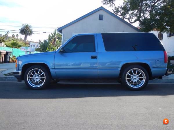

What did you use to get a 3/4 drop??
I put 265/60 on 18x9s was gonna run them up front but the truck needs to come down a bunch to sit right, I should have went with 255/50s on the same rim ... next time. Right now they are on the back, still thinking about 305/50s on 20s ... just don't want it jacked up like some sort of donkmobile lol.

I used, 1 inch drop spring and 2 inch spindle in the front, 2 inch hanger and 2inch shackle in the back.
