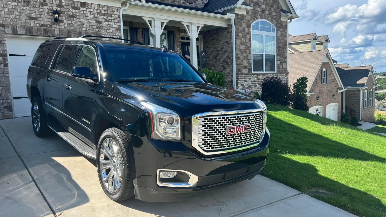

I have a 2016 Yukon xl Denali and when turning the wheel hear a sound like plastic on plastic. And also can feel some sort of popping in the floor board from driver and passenger sides when turning. Would like to know if anyone has had this issue before. And what was the issue and what did you do to correct the problem.
