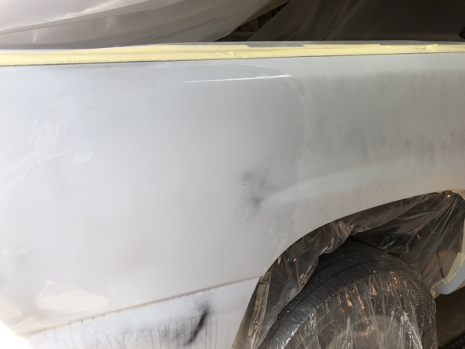

Working this am on wet sanding with 600. Spent a bunch of time blocking with 400 so this step is going much easier. I dust some black primer on and it’s easy to see where you’ve sanded and areas that need more.

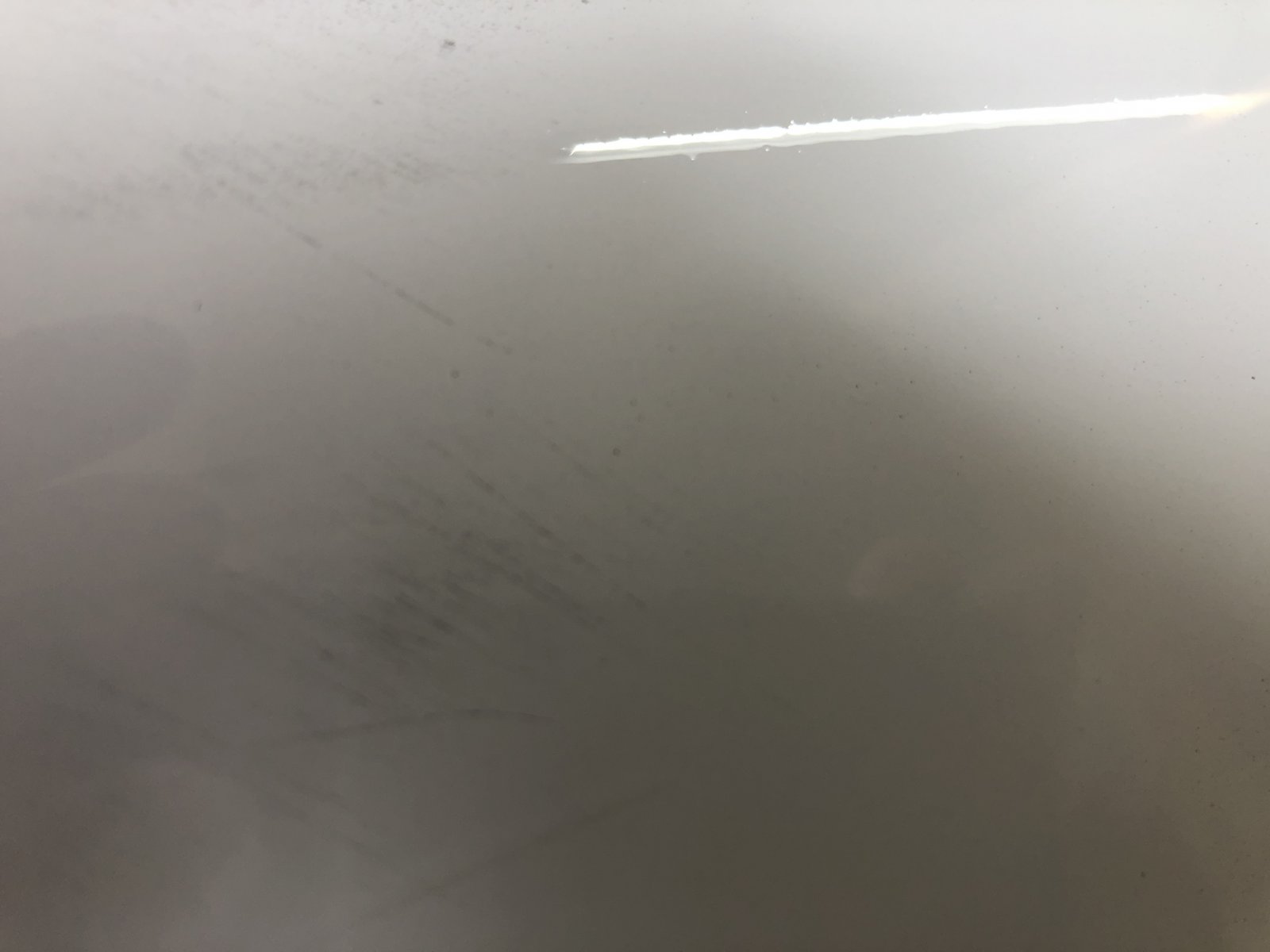

Sanded and buffed. Picked up a rotary polisher with a wool pad as my DA one with foam wasn’t cutting it. lol. The rotary does a much better job.
A lot of work sanding 1000,1200,1500 and 2000. I removed about 75% of the orange peel with 1000. 1200 got almost all of the rest. 1500 and 2000 goes much easier as it’s pretty flat by then.
