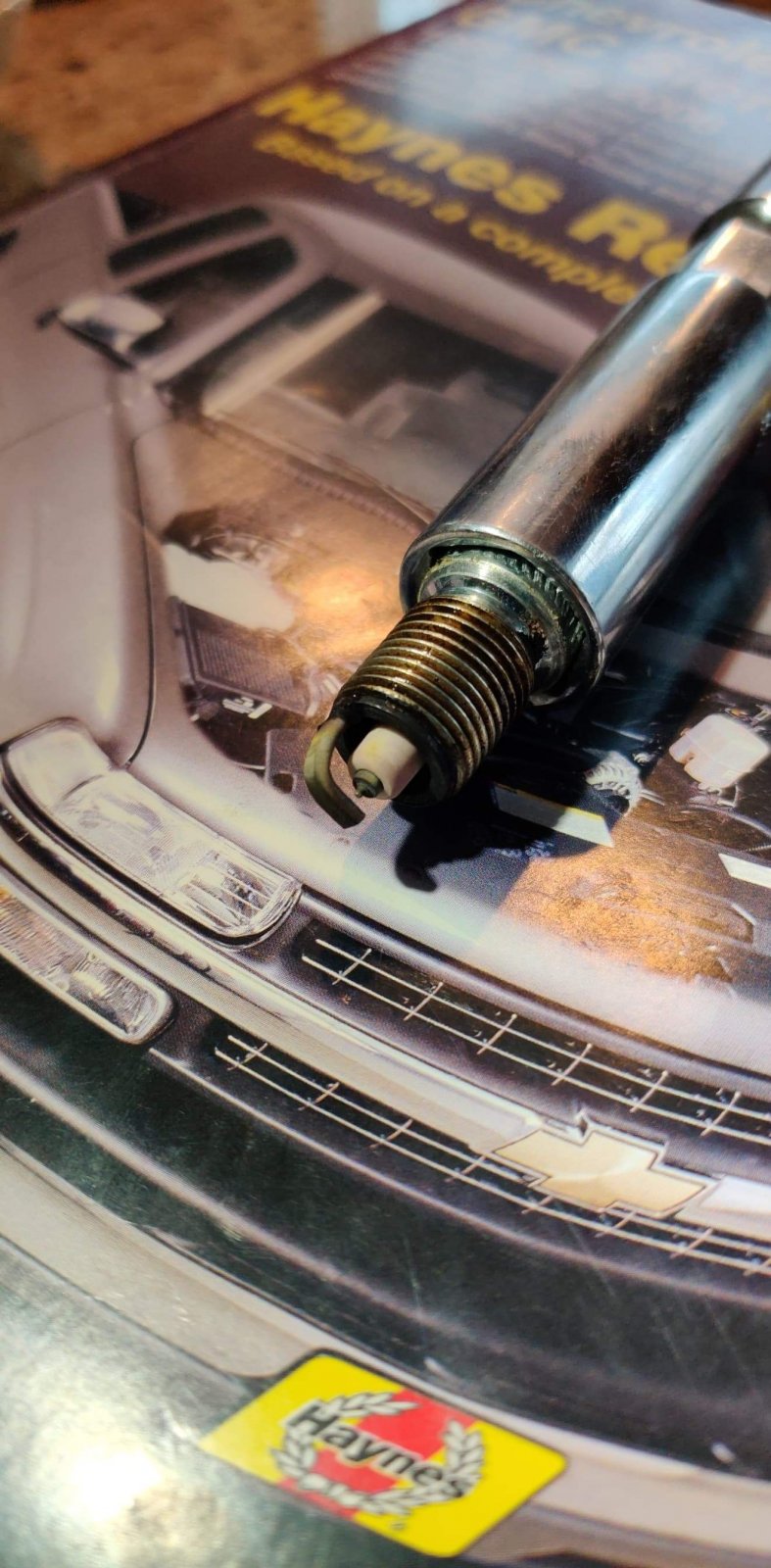

I checked #1 cylinder plug and it had a faint smell of gas, not wet, and nothing burnt on it.
The plugs are ACDelco 41-162.
Lol the plug wires are Ultima select I think oreillys brand

Just like the best shops and techs in town, they are hard to get in line with for work and info. That rich look I was talking about can be wet like you saw or a black soot look and the spark plug insulator will be black soot looking as well. If the plug is wet that means that the plug is not firing either at all or intermittently.

This is the #1 plug, I can pull more after I get off work in a bit. It looks fine to me. The threads looked slightly wet and faint gas smell. But nothing was burnt on.

It looks fine to me. I would still check all of them and remember what cylinder each came out of. Those plug wires? Are they the big thick 8.8 mm wires?

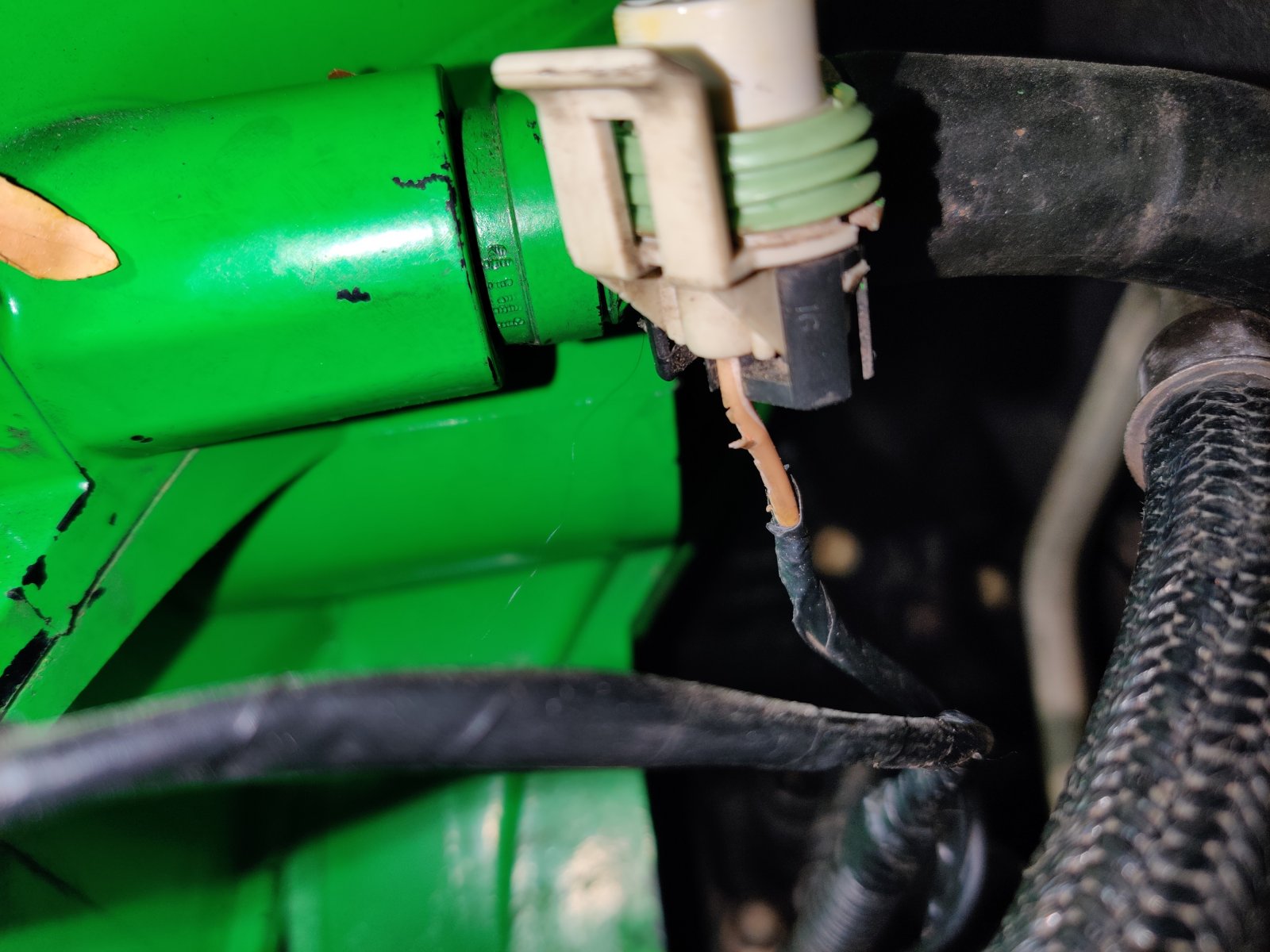

I may tear into the timing again then. But, before that, I did just notice a split in the insulation in the 1 wire for that camshaft position sensor.

You might do yourself well by replacing the can and crank sensors and make sure all wiring is intact. make sure when you plug wiring back in that the wire stays encased in the connector tab and does not push out of the connector.

It's a 1 pin connector, can't find anything like it on oreillys site.

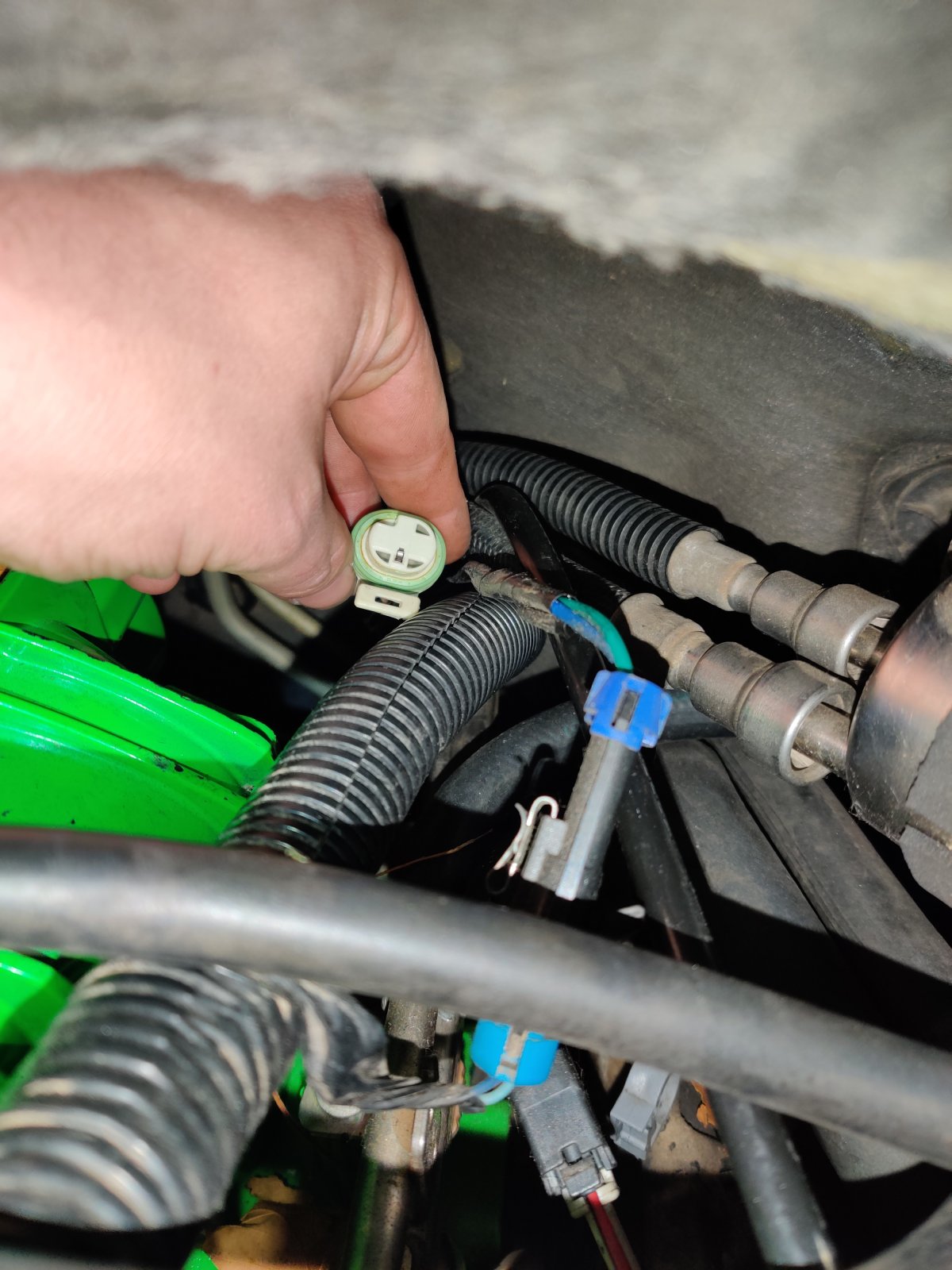

Aren't the cam and crankshaft sensor connectors 3-pin?
Well I guess that means I'm taking the intake off cause that wasn't the camshaft connect lol. But I'm confused. It's bolted downwards on the back of the block, behind the intake, what else is back there that I could have grabbed?
