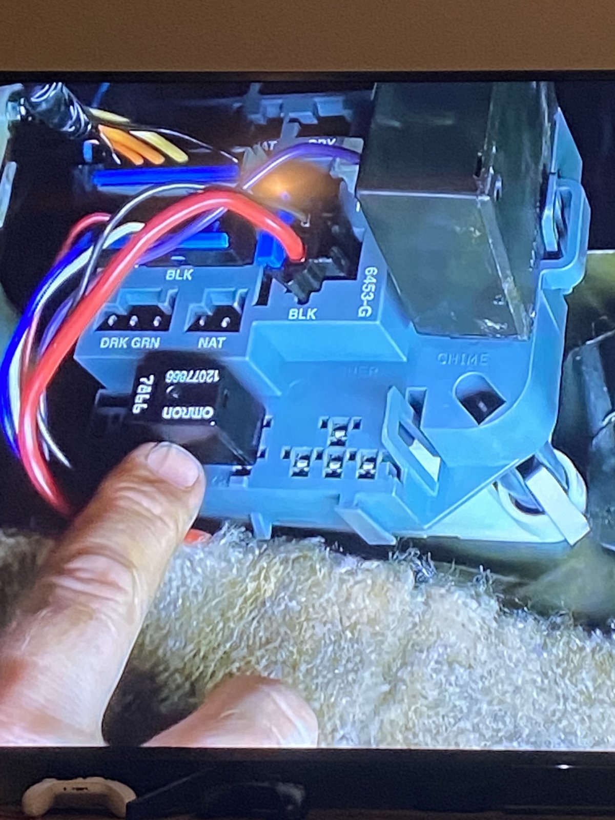

-First thing to check is Fuse #4 "Gauges" 10a, and #15 "DRL-FOG" 20a. With key on and a test light, you should have power at the fuses.
-daytime running light relay, located at convenience center (drivers side left footwell under dash) power should be at point 85, controlling the relay.

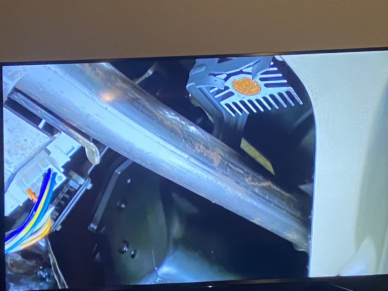

-In the video, the guy had a weak voltage at test point 87 of the convenience center. It ended up being a bad diode block underneath the dash, by the steering column, forward of the metal tube. The diode is a rectangular block, with cooling fins, with a circle in the middle.
-like the other guys said. There is a normally open switch at the top of the parking brake, with a light blue wire. If this switch is closed or parking brake is depressed or out of adjustment, no DRL.
Some of the guys may be able to help you out with a wiring diagram. If you change your mind about the video, grab some popcorn and enjoy! I sure did! Lol.

Brake switch is an open leaf where I can see both contacts and that appears to be working.
I have power at Fuse 15 with key on or not. Power full time. Gauges all work normally, so 4 is unlikely.
Relay has a 1, 2, 3, 4 & 5, no 87.

Are you looking at the junction box or the relay contacts?

I don't know if mine is older or newer.
I'm guessing my 5 is their 87.
