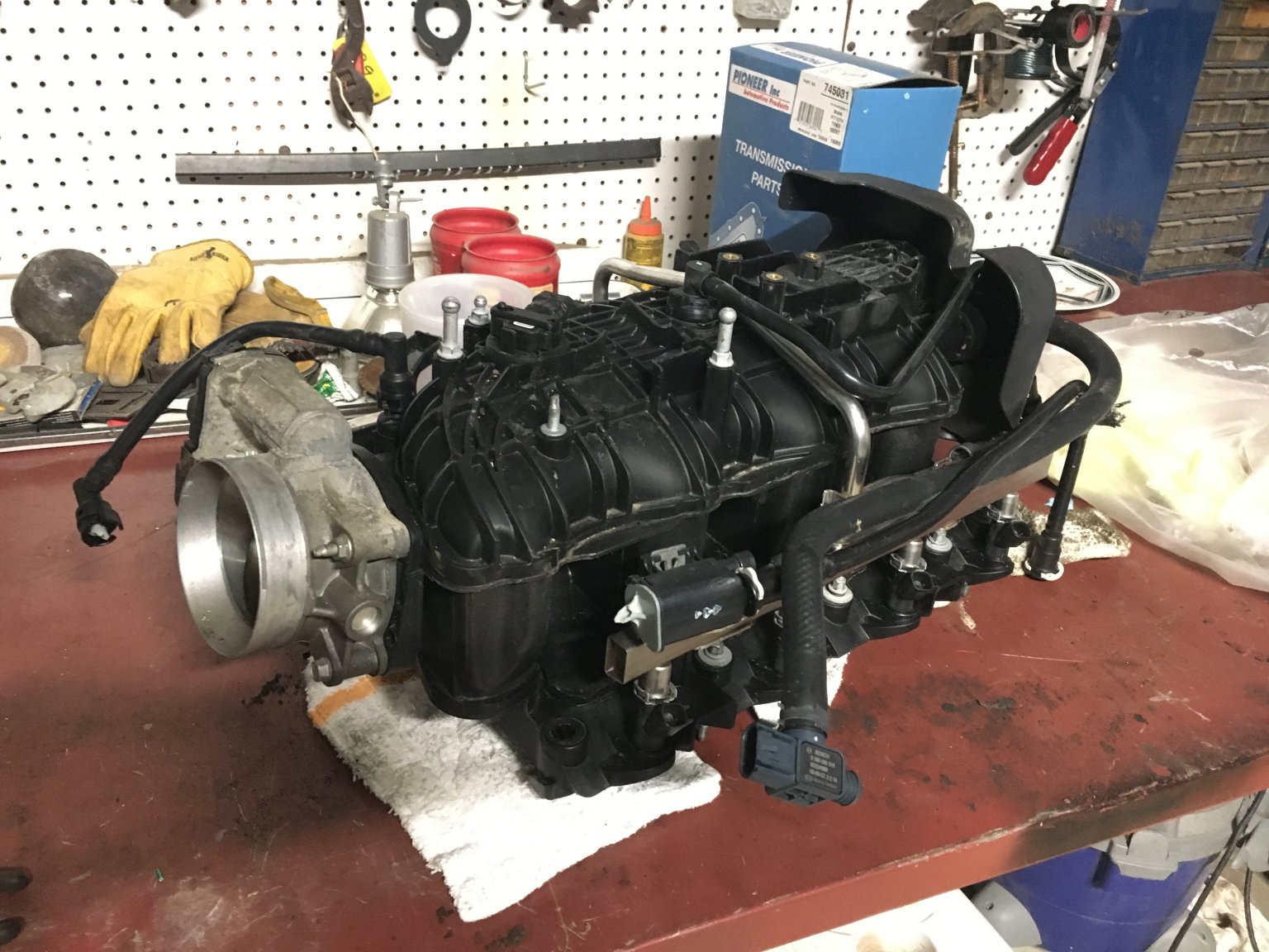

Hey guys I've been doing a lot of research on this and I'm going to start looking at u pulls for parts but here's my question. On rockauto they have 2 different intakes for a 2008 yukon depending on if I get the 5.3 or 6.0 intake. I have a 2003 yukon denali so do I need to look for a nnbs with a 6.0 or will any motor work? Also what years and models can I get an intake and throttle body from? Sorry if this has been answered before.

Everything I've read said it was good for 20 hp. It's a stock plain Jane 6.0. I have a leaking intake gasket and I get get an intake and throttle body from a nnbs intake for free. I would only have to purchase an x link. Do you guys think I will notice any improvement or are these intake swaps meant for built motors?

Thanks for the heads up. I can get the intake and throttle body for free from a buddy I'm curious if it's an upgrade or not for a stock 6.0. If not i might just keep it stock I just read online for the 5.3 it was a decent upgrade. If it'll add some ponies and help with the high altitude in Denver I'll do it. If not i guess I'll stay stock.

Also if it is an upgrade to the nbs 6.0 RockAuto lists a different intake for the 5.3 and the 6.0 nnbs. Does it matter if I get an nnbs 5.3 or 6.0 intake will either work? Or do I need a 6.0 nnbs intake for my nbs 6.0 denali?

The intake manifold is an upgrade. I have read about occasional failures with the xlink.

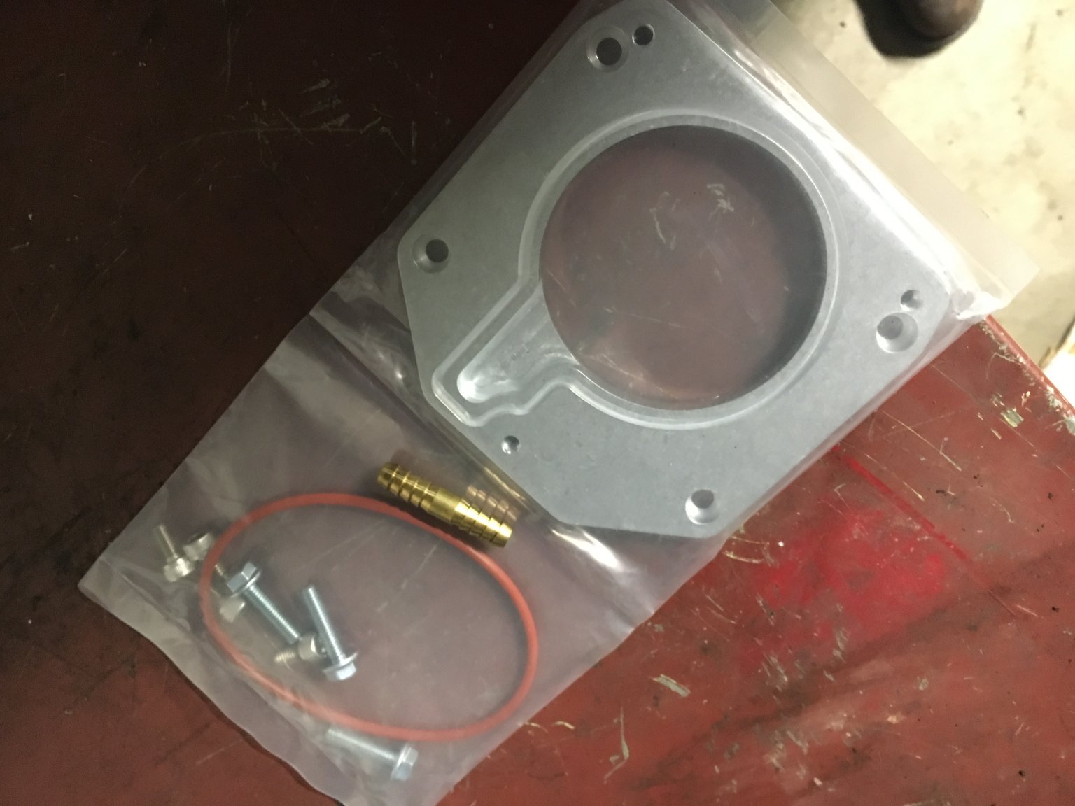

from the link already posted in this thread:
u have some options here. to run your stock 76mm TB, u will need to buy an adapter plate. thats the cheapest route. if youre like me and cant justify a big ass expensive intake and keeping a stock TB, get u a 90mm LS7 TB or run an nnbs TB. for you to be able to run a different throttle body (the LS7 or nnbs TB) u will need to purchase a DR X harness from torquerushperformance.com. its ~$240 and looks like this
