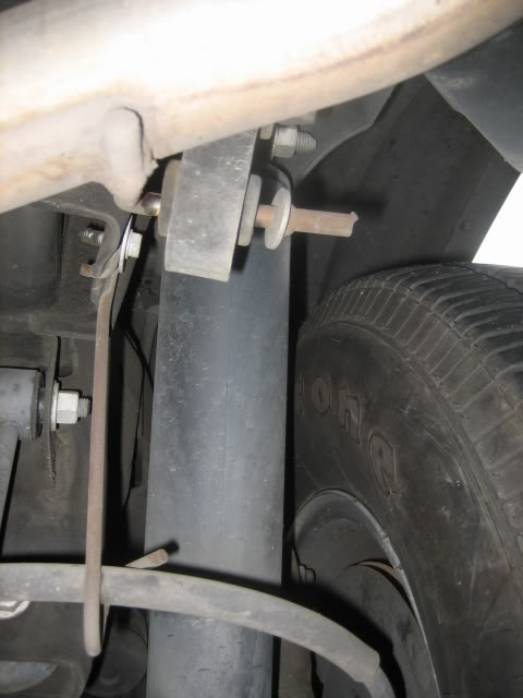

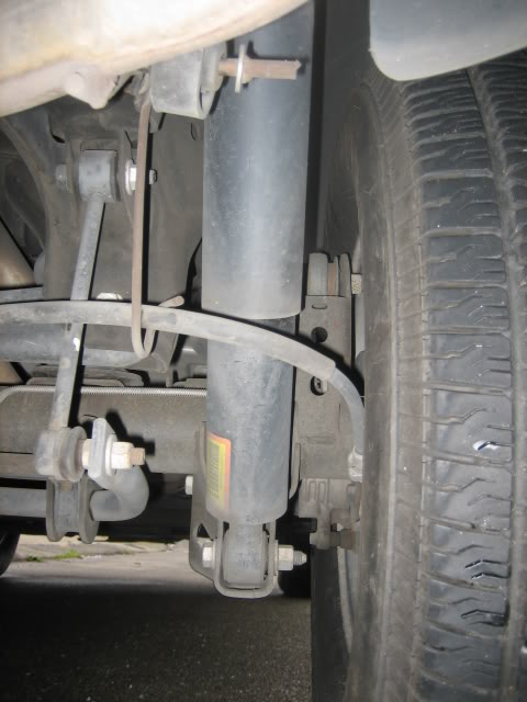

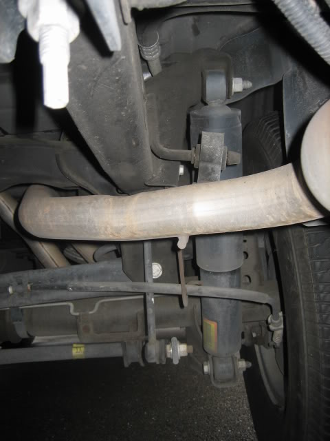

Can anyone tell me if these are nivomat/autoride/self leveling OEM shocks?

It looks like nivomat Oli. I tried to look up pics to compare but I didn't find any. I did find descriptions that match what your showing. I have never delt with nivomat shocks but Nivomat and autoride are 2 different systems though and these are not autride shocks. You can tell because they have no wires running to them. Auto ride is electronic dampening. So that's a good thing for you.
I did see the prices for the nivomat shocks and for the price of one replacement you can get zcoils, load assist bags and better shocks. These things are every bit as expensive as the autoride shocks if not more!!
