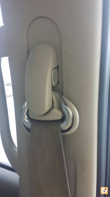

  6. The piece that covers the seat belt bracket at the top is missing and I can't seem to find a part number for it. Not sure exactly how to describe it, it goes at the very top of the seat belt next to your shoulder.

6. pic?

That seatbelt is actually supposed to be like that If I'm not mistaken
x2
all of mine do

As far as the seat belt I did notice that the plastic trim piece around the metal part is not properly attached to the metal piece. Hope I am explaining this right, lol.
