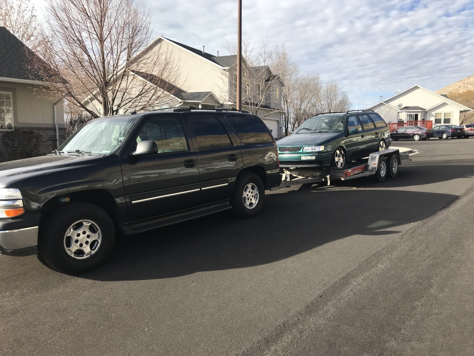

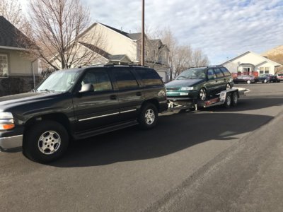

Here she is towing my project vehicle on a 250-mile trip

Sounds like you got a great deal! I also had to replace my fog light a while back, the lens cracked and then fell off, but it was a real easy fix.

Nice looking tahoe man! That’s the score of a lifetime with that low miles and price! I’m jealous! Sounds like you’ve been having a ton of fun with it! Can I pay you to do work like that on my truck?! Hahahah
