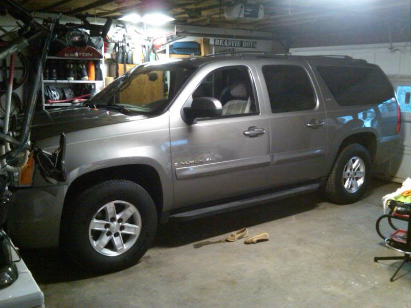

Hey guys, Finally decided to let the 03 go. 03 SLT that had 153k. Was a great truck, didn't ever have any real problems.
With the family growing and lots of trips planned i bought this yesturday
07 XL SLT Quad Buckets w Nav and autoride. 146k on it.
Very clean one owner.
Drove a few hundred miles to get it and it drives very nice. Test drove 5 or so of the new body styles to get the feel of them and this one drove nicer than some with half this mileage.
