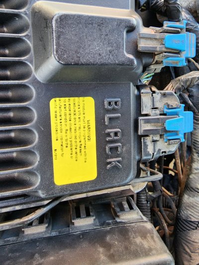

It looks very clean...maybe a return to wherever they bought it from? I don't think the shop is scamming but I am a little disappointed in the shop, with that sticker there and all...

That looks like a reman ECM. Just needs programming. Takes about 20 minutes or less. Ebay price is usually the same programmed or not because they are plugged into it on the bench already.
Well it's been programmed... To a 97 Sierra with a 305! Im guessing that whoever the shop got it from sold them a return that hadn't been cleared out.

Remember that ECM fits many, the software(programming) is different. So looks like a call to the shop to find out if They can re-program it, or send it back to wherever they got it for reprogramming.
