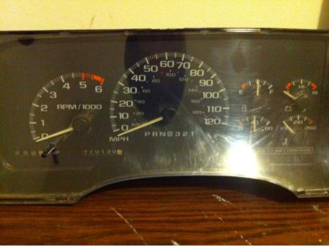

Basically, that and the white needles instead of orange needles are the primary differences. I believe it's a drop-in replacement for obs 96-99 and 2000 obs tahoe z71. These gauges are originally found in 99-2000 denali's and escalades.

the denali escalade gauges, have the 120 mph, clear needles, blue backlights, 6grand rpm
stock gauges have 100 mph, orange needles, white backlights, anywhere from 5 to 6grand rpm..
police ones are like stock except 130mph..
