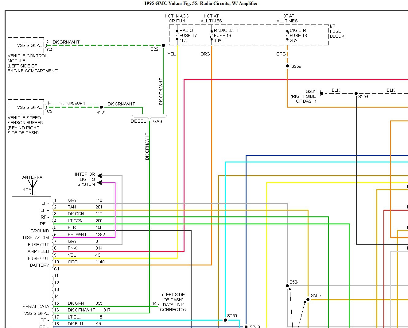

According to my wiring diagram:
Fuse 17 (10 amp) is the radio power wire and it is yellow
Fuse 19 (10 amp) is the radio memory wire and it is orange

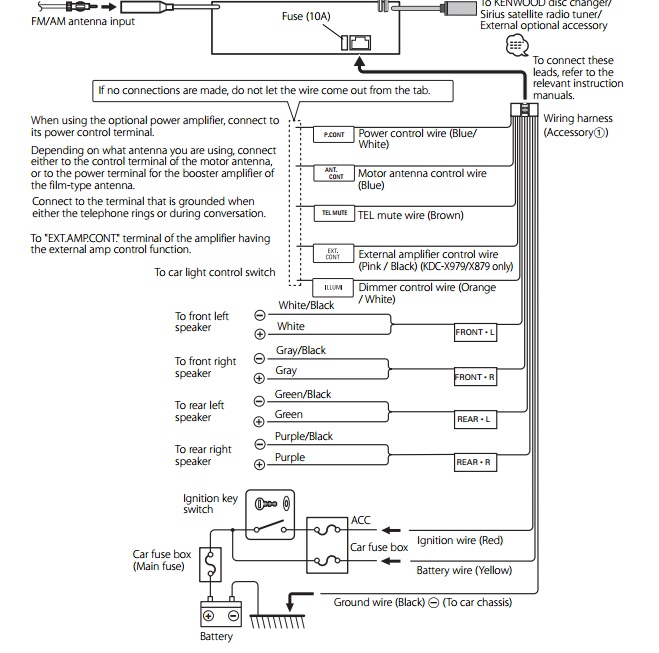

Which fuse? The radio fuse on the side of the dash or on the back of the kenwood radio?
Some wiring diagrams:
radio side:
memory-yellow
power-red
truck side:
memory-orange
power-yellow

oh!!! i'm not using any of the factoy wires to power the radio .I have dual alts so my system is only wired to the
second alt and the two batts in a (nut shell) i have 2 separate charging sytems going on here. I took the 979
out and put my x769 back in the dash. i'm taking the x979 to the shop to see whats going on with it hope it can be
repaired with out a fortune. i will miss the 5.1 surround
in my truck until it's fixed.
