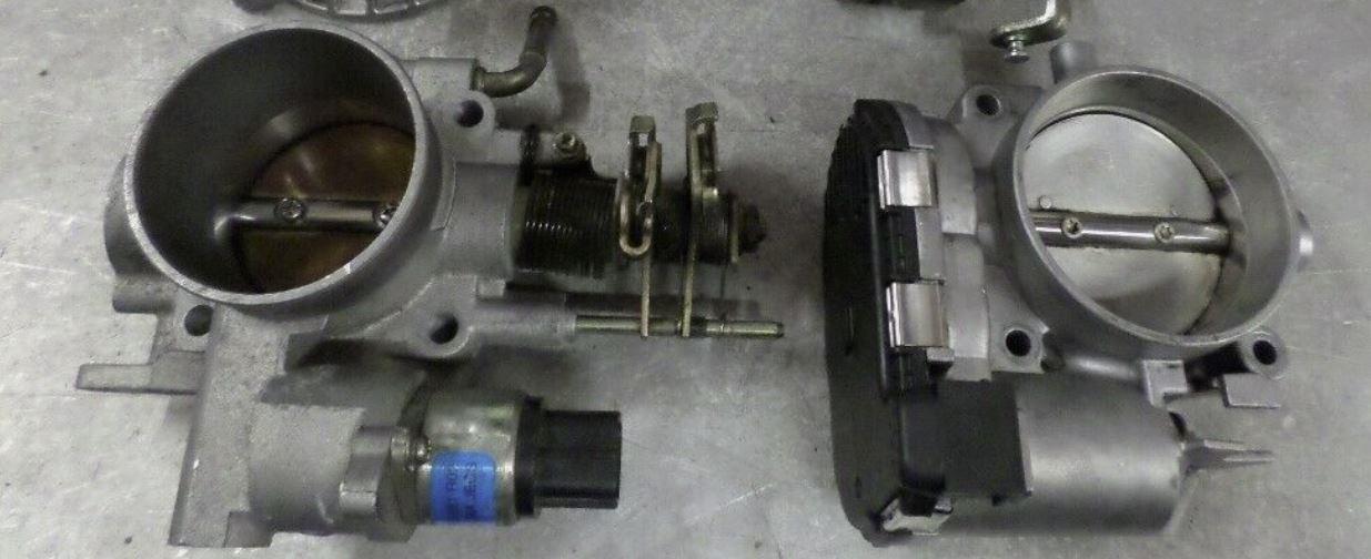

his has a IAC idle air control valve, which is what controls the idle primarily mechanically anyway, the 00-02 had them with drive by cable, previous years probably did as well as egr, in 03 they went to drive by wire with a fully electronic idle control (single piece unit),
lots of them in junkyards, cheap fix if it is the iac, unless you want to buy a brand new one
in the photo below the one on the left has a iac which bolts on and has what looks like a metal ball inside, the one on the right is drive by wire it also has a iac but it is all electronic
