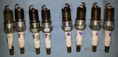

I got the dreaded P0300 code yesterday after work. As soon as I started my Yukon, I noticed the idle was rough. It was slightly stumbling at idle in gear and had a large loss of power when accelerating; it sounded as if it was running on 5 or MAYBE 6 cylinders. SES light came on then started flashing. The it went solid and starting flashing again.
I made it home and immediately pulled and changed out the fuel filter...wasn't necessary. I then checked the fuel pressure. It checked out. This afternoon I tested the TPS, which also checked out. I pulled the plugs but didn't have time to pull the distributor cap yet. The plugs, cap, and MSD wires were installed 9,000 miles ago.

the plugs are pre-gapped at .060". #2 looks wet with something, perhaps you know with what? #5 looks real dirty on a part of the insulator or it is cracked. can't see clearly. #4 looks to have a crack on outer insulator as well. #1 is just F*****. Next course of action is to finish your inspection but regardless replace your spark plugs with delco 41-993 or autolite xp605, also pre-gapped. Cap should be delco or delphi unless modding the ignition output.
