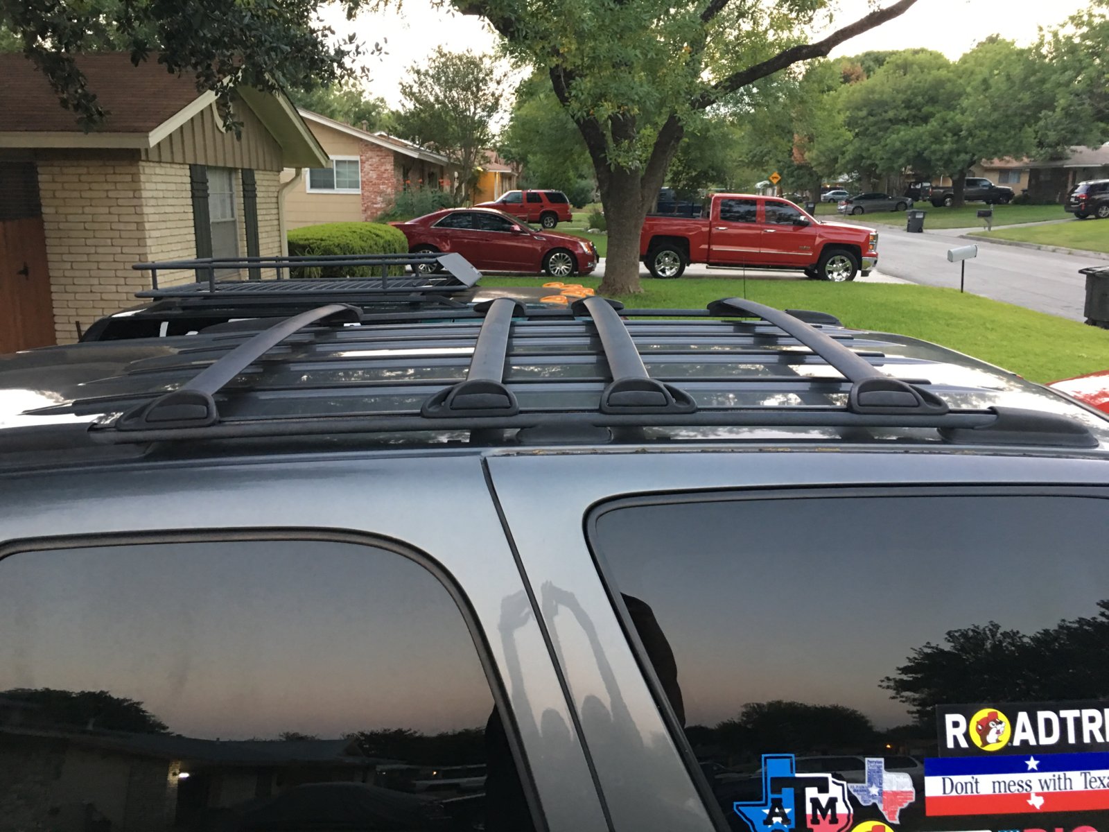

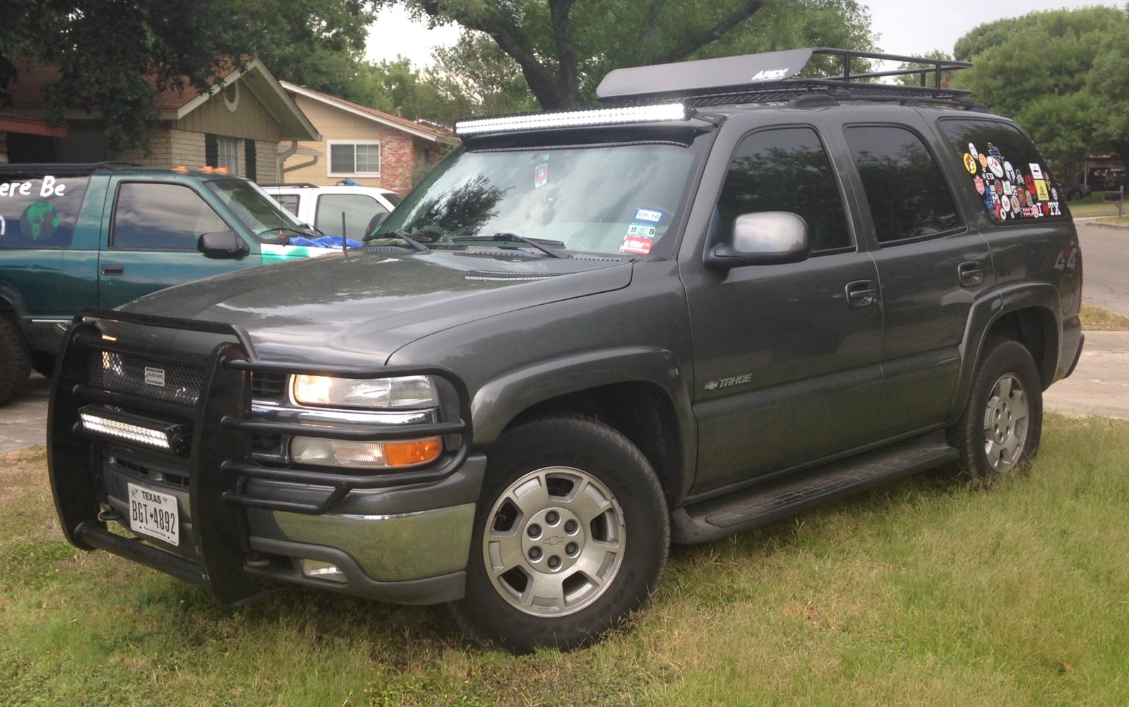

Finally picked up those roof rails that I bought a couple months back and threw them on, in preparation for the roof rack off the green truck.
Now that she's up off the ground it won't look as weird as before.

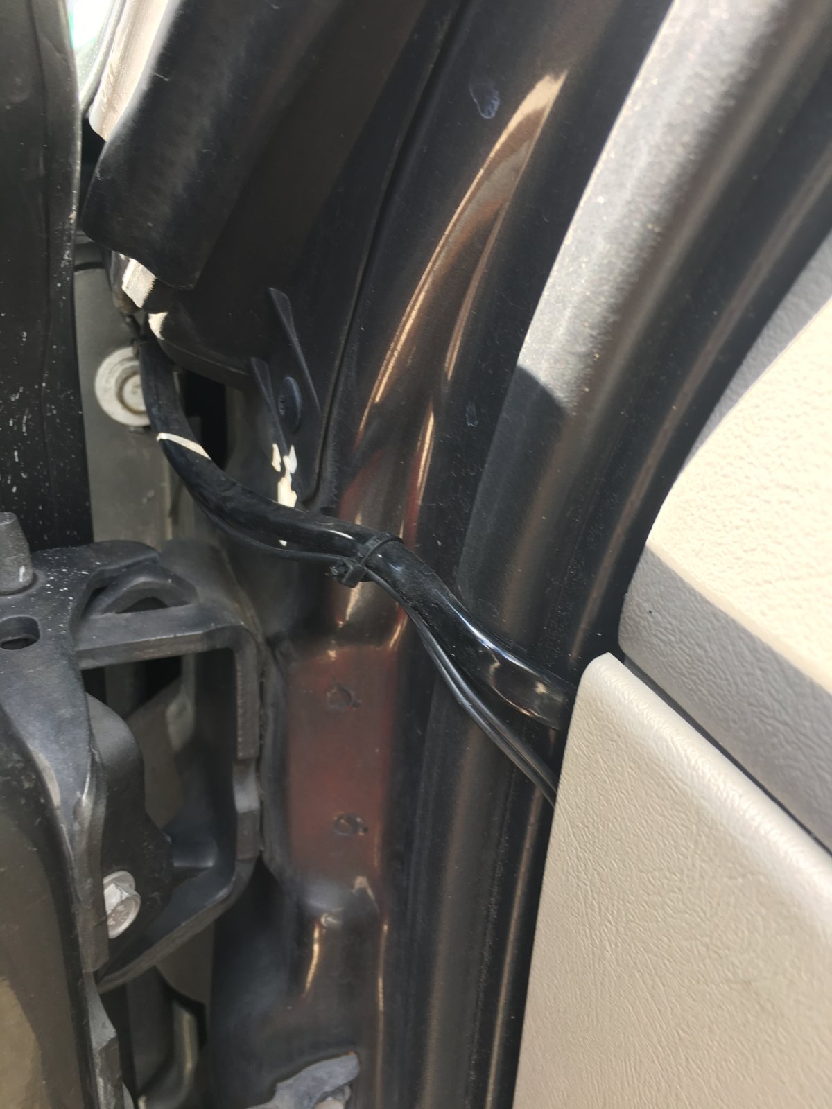

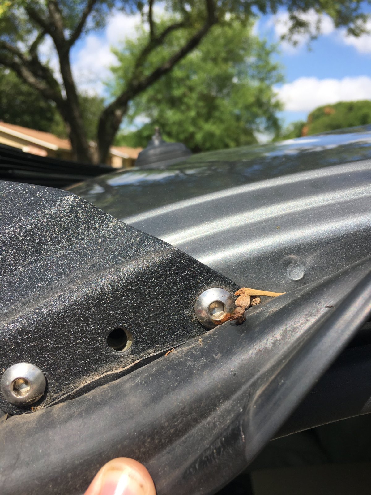

Just up the a-pillar and under the weatherstripping, into the engine bay, and I still need to run the wires for a proper switch through a grommet into the cab (I just have the little button that came with it now, fed through the doorjamb) @bluebear15
Any pictures of how it's mounted? Do you have to drill holes or use existing ones? I've always been curious

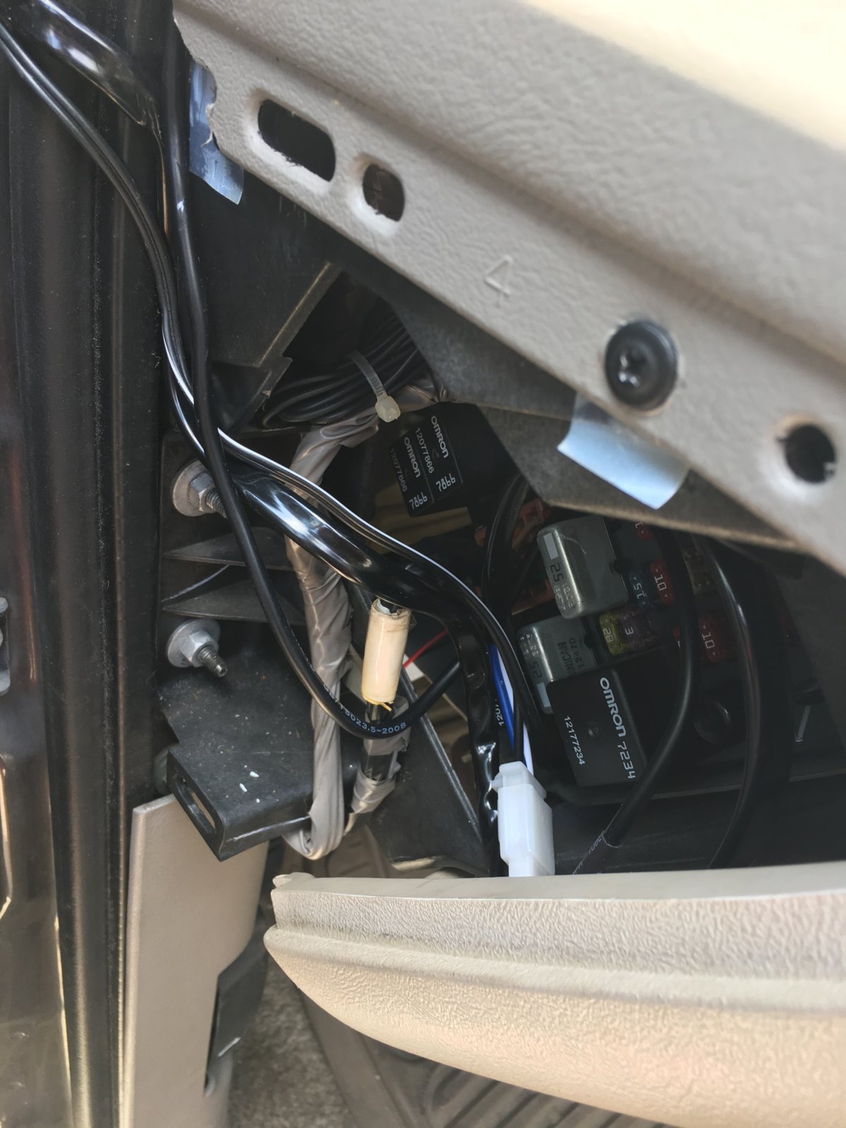

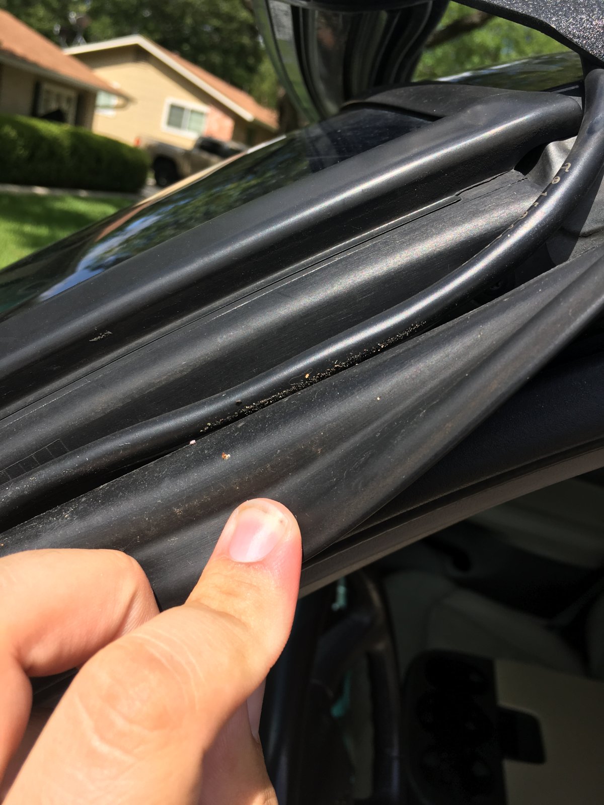

Yeah @bluebear15 unfortunately I did have to, and trim some of the weatherstripping as well. It's held in by rivnuts that I still have to really seat in there. I had just superglued it in place. But it's been pretty sturdy for well over a year now.
View attachment 180828 View attachment 180829 View attachment 180830 View attachment 180831
Thanks! That will be helpful when I install mine. Do you have any leaks from it? Just didn't know if had to use some silicon to seal up or something

If it rains like cats and dogs, then it does a tiny bit. Some silicon would probably help, but it's unnecessary.
:eek::eek::eek: You should run the lightbar wires into the engine compartment then feed them through the grommet on the firewall back into the cab...guaranteed no leaks and no chance in shorting those wires out from constantly opening and closing the door on them brother

Yeah it's the next thing on the list haha. Luckily they're very flexible and I haven't had any problems yet.
