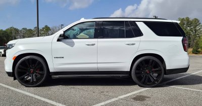

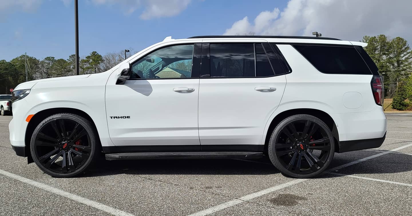

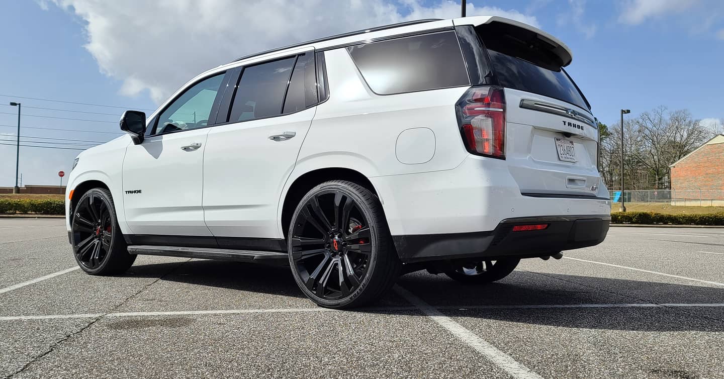

Long story short, i found a way to lower these trucks through a different forum. Finished the install last weekend and it looks so good!! Here is a video from my youtube channel of the install.

creative lowering, looks good
might not tow as well.
how does it drive & take bumps & such?
soooo spill it, what'd you have to do lol
the ol' bolt the struts to the bottom of the arms?
its in his vid, belltech lowering kit for 07+ 2wd, then swap front springs to rear.
