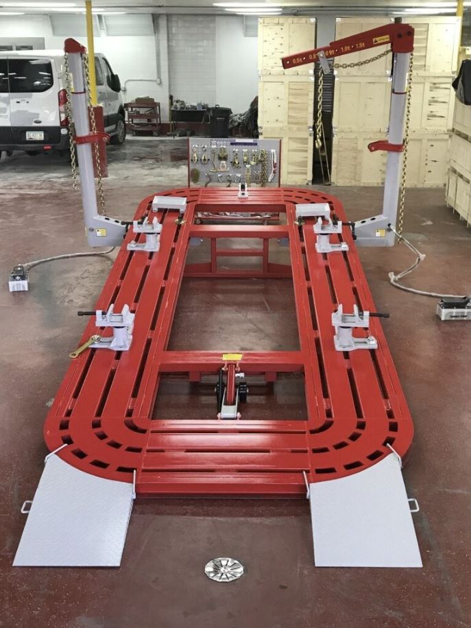

I've fixed front and back that way, my wife rear ended someone and wrinkled up the front end I fixed it myself, pulled the bumper off and pulled the radiator support back, took a crow bar and straightened up the front frame mounts for the bumper, bought a used hood same color, bought a used hood release, bought a used bumper and replaced the windshield fluid tank with a dorman, bought a used drivers airbag and a used srs module good to go. you couldn't even tell unless you looked up behind the the bumper and saw the mounts were slightly misshaped but everything went on straight. then she backed into a pole and bent the back bumper up and busted a tail light I just bought the kit as mentioned above off ebay and some new led brake lights and she's golden, fixed a few other vehicles in similar fashion before over the year as well. as long as the frame is not totally ***** you can do it with simple hand tools. If the frame is bent there are shops that have frame straighteners, pretty crafty tool it's like a flatbed tow truck bed

In my early 20s, I had a girl hit me semi head-on, but at an angle in my '93 Civic. The front was racked sideways a little, so I had a body shop tug it on their pull table for $150 and I pocketed the remaining $1,350 I got from her insurance.
