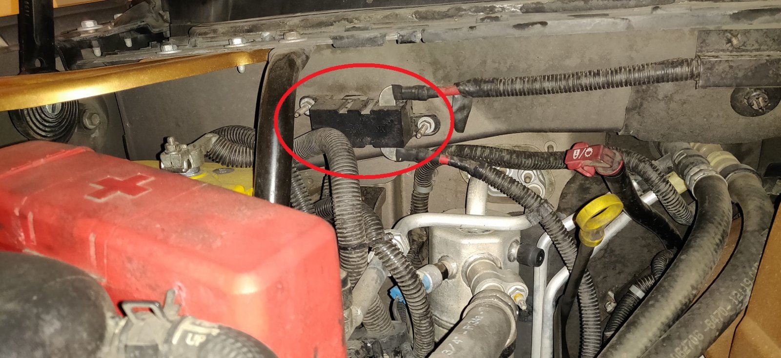

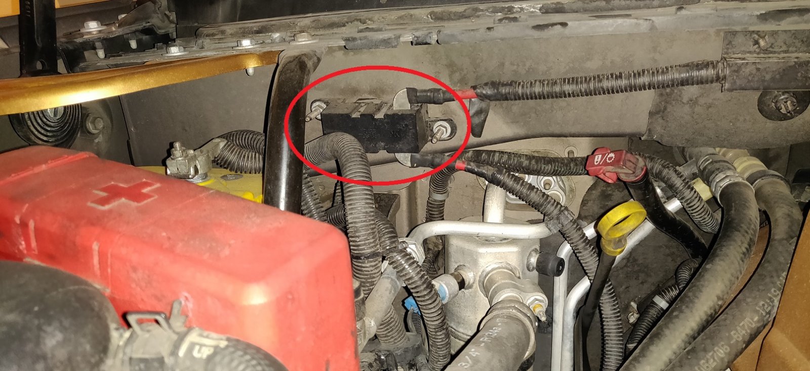

@Doubeleive , did you have to change the fuse on the firewall with the high output alternator? The default is 175 amp. did you upgrade this fuse?
30,521
47,941
@Doubeleive , did you have to change the fuse on the firewall with the high output alternator? The default is 175 amp. did you upgrade this fuse?View attachment 222161
no I didn't mess with the fuse, I don't think that is related to alternator output I believe that is intended to be a fusible link in case of a short circuit. but I am just guessing based on how it is installed in the trucks
