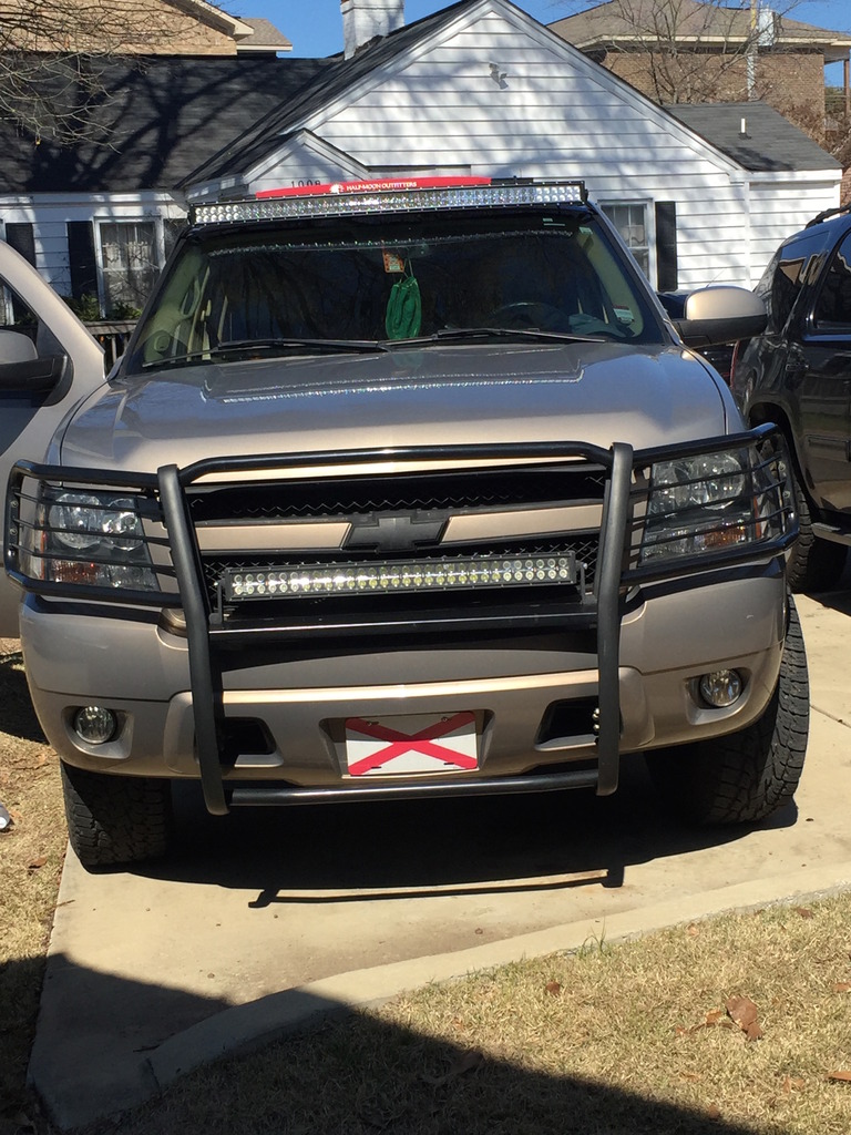

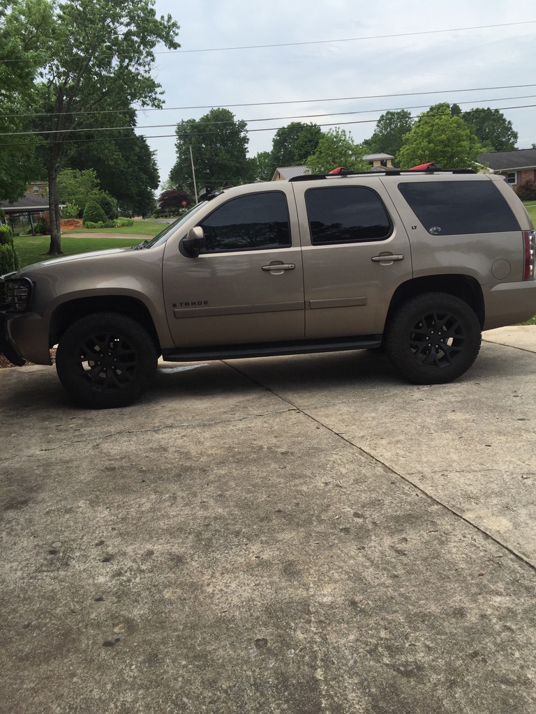

Ive been on here before but my modding for the Tahoe went idle for awhile and now I'm interested in getting a 6 inch lift. The local shop wants $2000 for a Rough Country 6 inch lift installed. To be 100% honest I do little offroading in my Tahoe, its 2WD, its an aesthetic thing for me, I like the look of lifted Trucks. But I was curious if the rough country is good, or if I should go with another brand? If another brand which ones and why. it Currently has a CCM 2.5/1 on it and I would like a lift that either makes it completely level or even a tad higher in the front. any help would be greatly appreciated
Heres a few pictures of how it sits now
Front:
Side: theres a slight slope in my driveway, but it sits level when its on flat ground

dont do rough country. do fabtech or fts. rough country only drops the diff and lower control arms 5'' where the fts and fabtech do a full 7''. so the ride will be a lot better. worth the extra money. also fabtech has the best designed rear kit for the tahoes

shit i just saw your 2wd. so look into the maxtrac 4.5'' spindles and then do a 2'' rear spacer. I'm just not sure how the rear end will handle a 2'' spacer, you may need new shocks and pan hard par with end links but not sure
