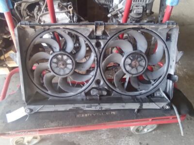

if you want the 7/9 blade you can find them in hummer H2's and Escalades or others optioned with k5l, seems like they only made the 7/9 blade for a couple years around 07-09
the motors are 700w, left & right motors are different (shaped different and mount different) and so is the way the fan blade mounts
these motors only fit the 7/9 blade housing

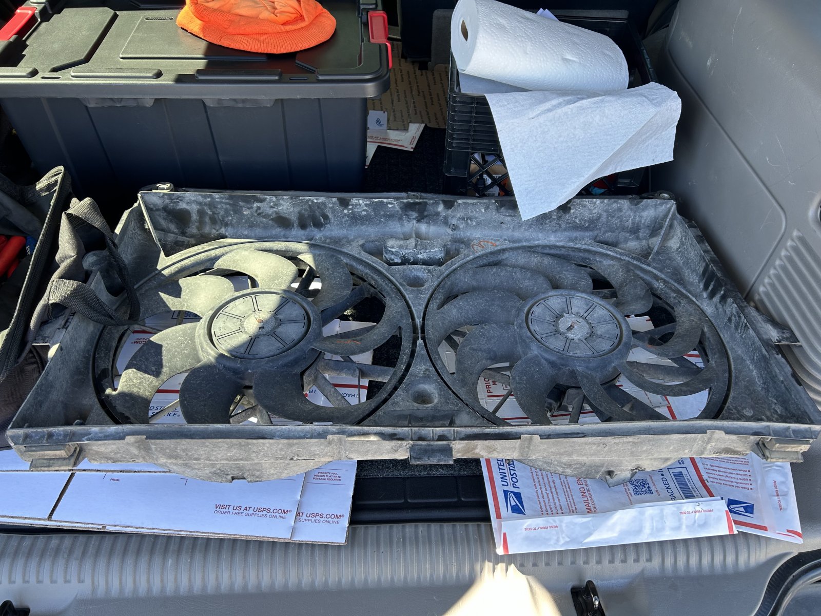

I scored today! I remembered at the local wrecking yard seeing a PPV GMT900 Tahoe. I looked up their inventory and ran the VIN to find K5L.
Showed up to it and the fans were still in it and in great shape! Super stoked for $25.

Thank you though for the part numbers and the offer advice. I think these 7/9 are not ever listed correctly.
Will degrease and wash them up this afternoon, take em apart and put the new motors in and give em a spin.
Think I’ll hook up a tech2 and make a video of them on low and high just for reference for others.

Got the blades off, motors unbolted and everything washed.
Good call on new motors. These spun hard with some bad spots felt in the armature. And they look crusty.
New motors showed up. Genuine Bosch.
Time to assemble.
