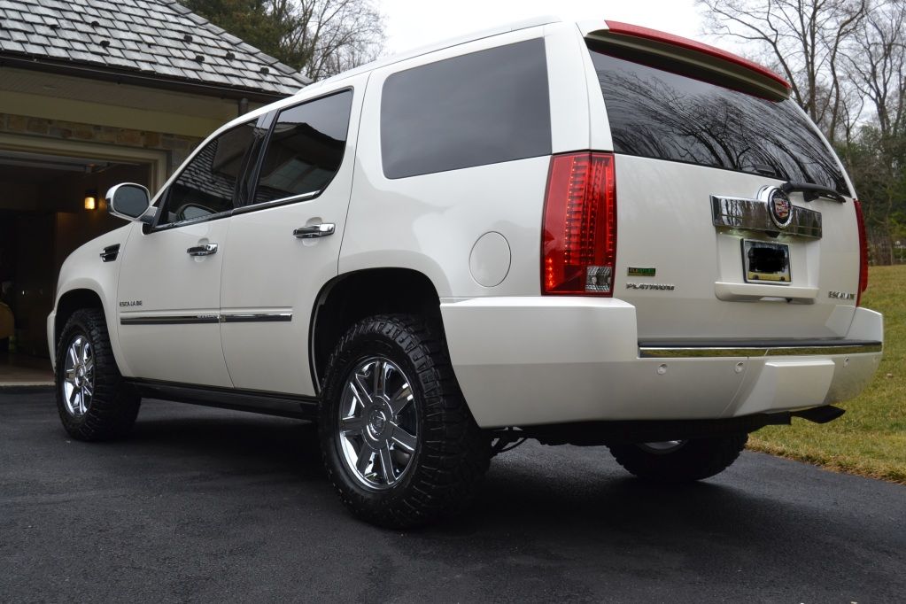

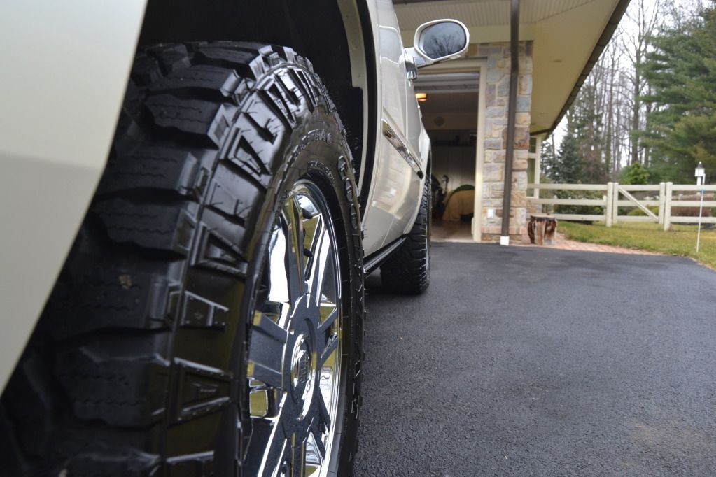

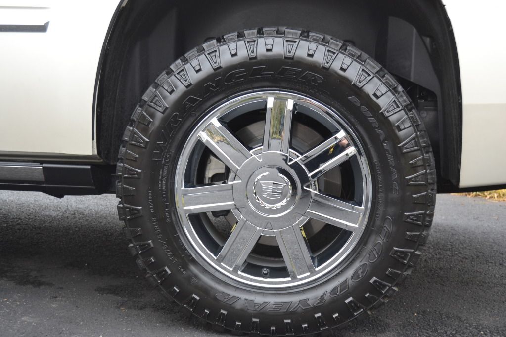

That was the stock size of the tires on the 2007-2014 Escalade's if you got the 18" wheel option, it's the same basic outside diameter as the 285/45/22's I used stock chrome 18" Escalade wheels for my DuraTrac and my Blizzak's for the winter, and switched back to the 22"s for the nice months

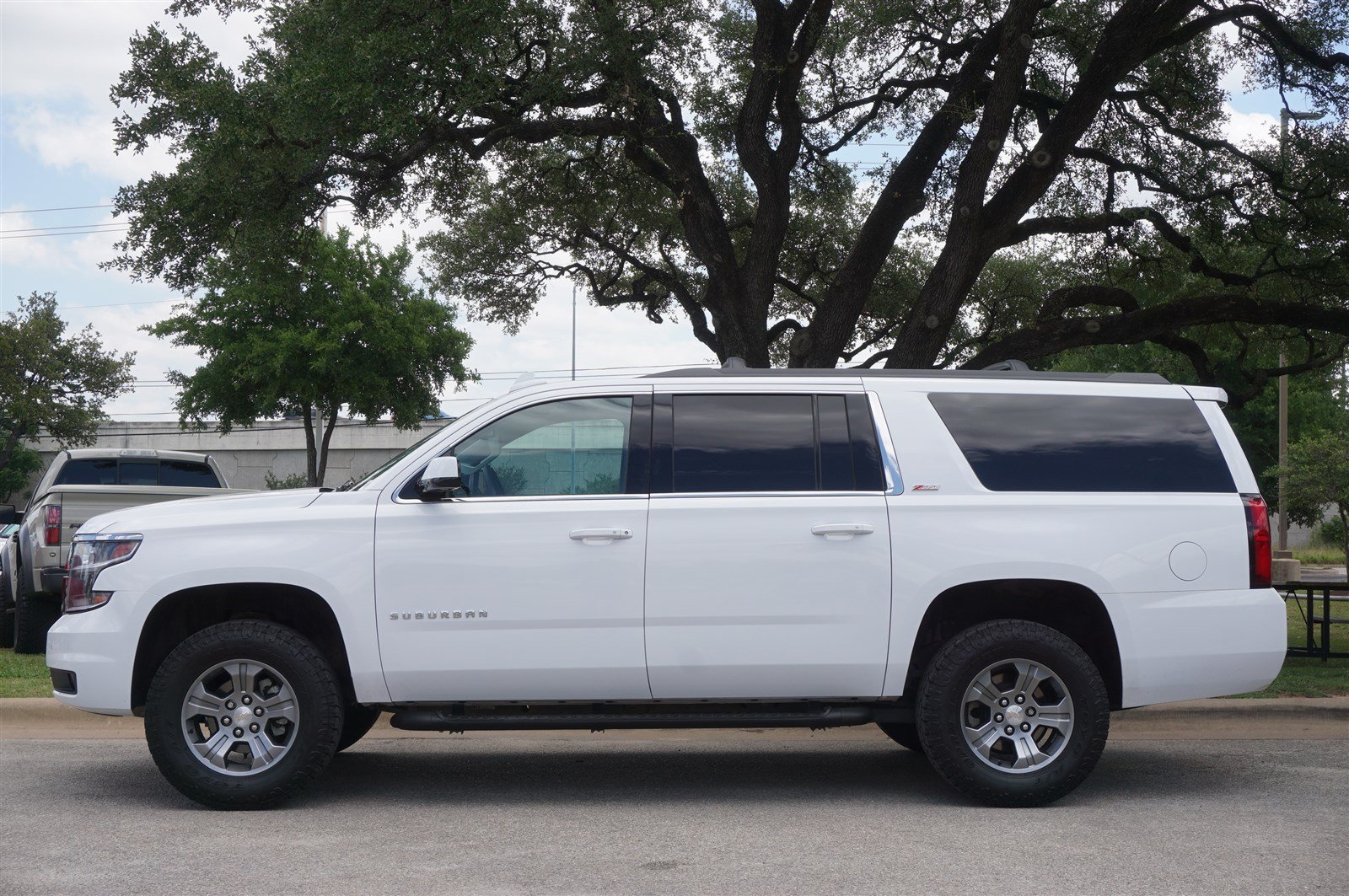

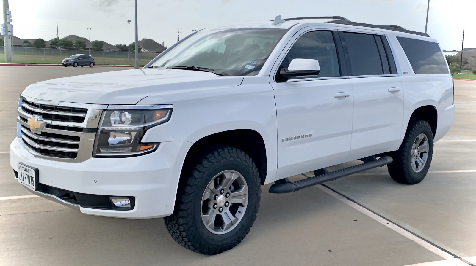

Top is mine with Bilsteins set on the second ring (1.25” I believe). The second picture I believe is a 2” lift.

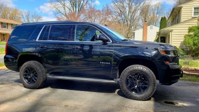

275/65/18 duratracs (32.25") and a 2" Rough Country front level and MOOG HD rear springs. I got a great deal on the take-offs, duratracs are way more tire than needed and will probably go with a decent AT when these ever wear off ( 18/32" brand new). Also the duratracs seem to have a narrow tread patch compared to the 275/55/20s I have on my 2008 tahoe.
