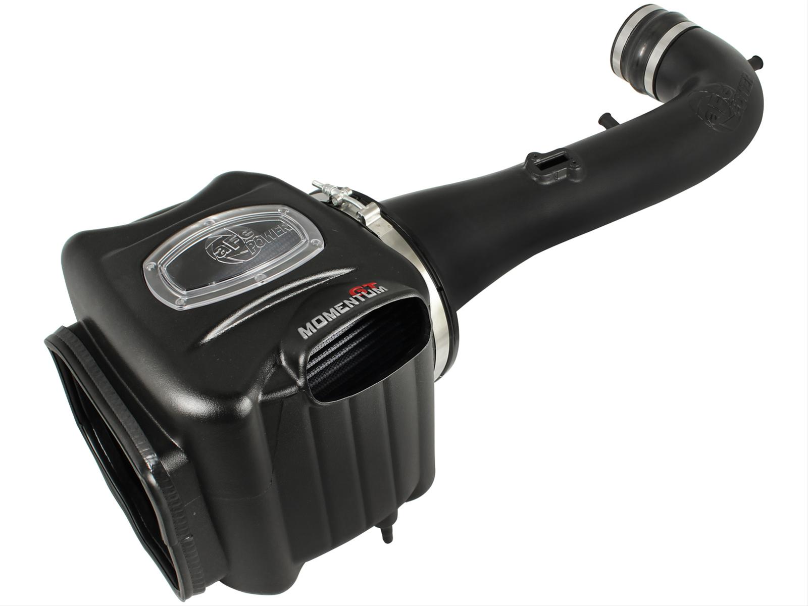

Eventually I punted and yesterday I just ordered shorty Flowtech headers from Summit Racing, along with some heavy duty rear springs (my current springs are sagging a bit) and a aFe Momentum GT Pro intake. I plan to install all of these things myself when I'm back east. Then I'll get a tune from Black Bear.

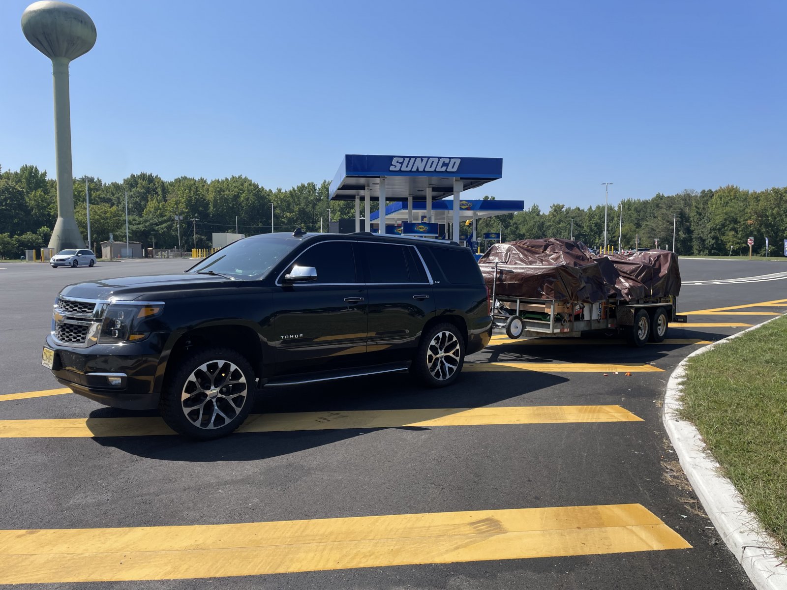

I'm in Miami all week, but when I get back to Jersey, I'm installing those heavy duty rear springs lol. Also going to install the shorty headers. Then I'm taking the trailer out to Missouri to pick up my new-to-me MG Midget.
In the mean time, check out this silly looking squat lol
