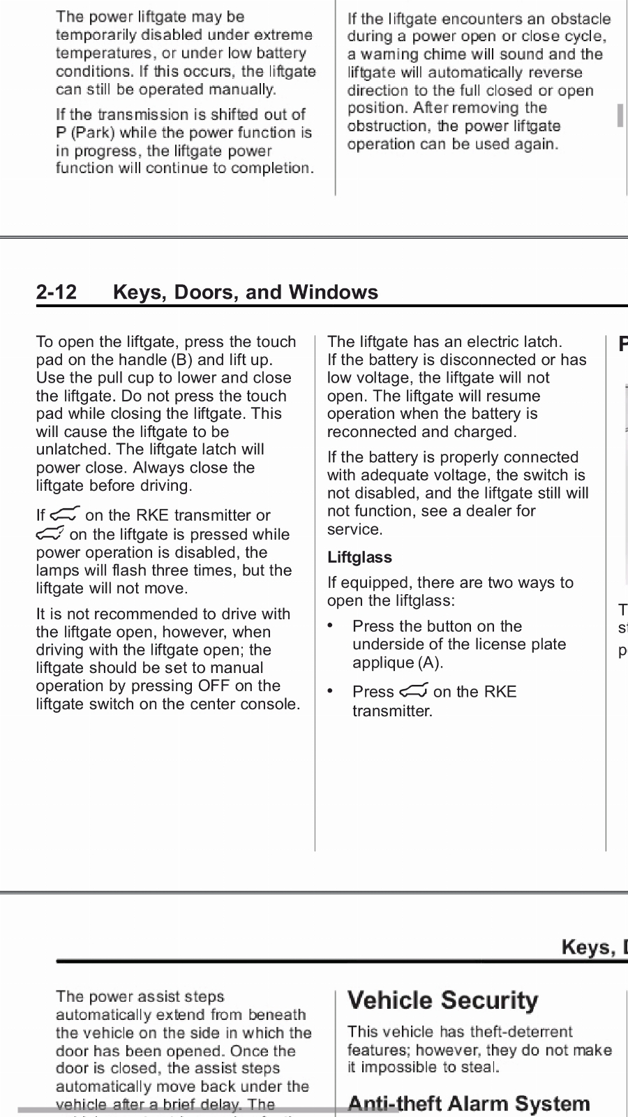

I have googled and read the entire manual and cannot find a way to open just the glass of the rear hatch instead of the entire door... Is the glass handle just there for looks?

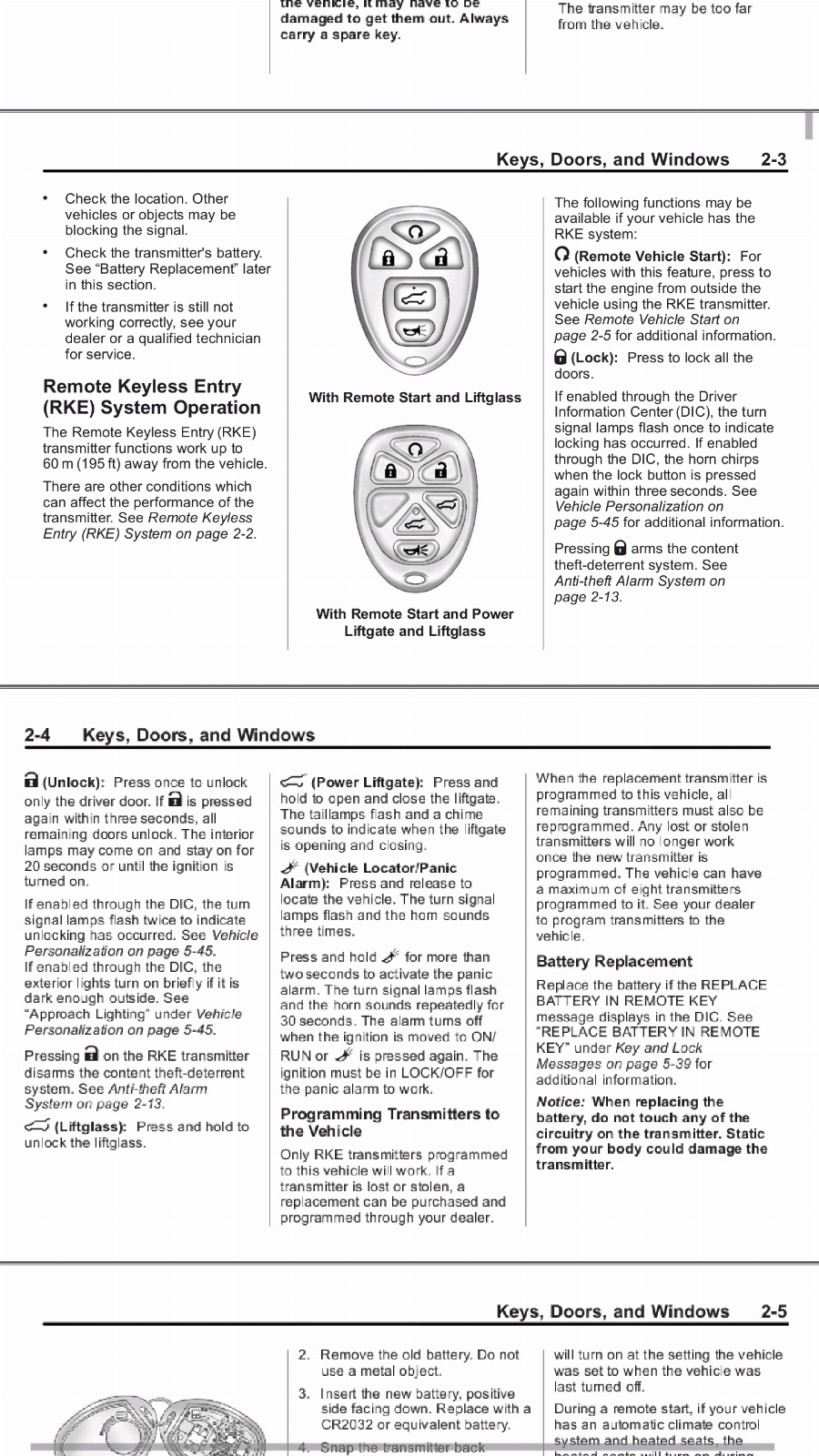

Hi Hannah, there are two methods. First there should be a button on your fob. The right one, not the bottom.
Second, there is a secret button to the right of the license plate. It's a rubber covered switch that does wear out, so yours being a 2008, it may have fallen off and needs replacing. This video shows where it is and how easy it is to replace:

Awesome! Still learning new buttons and accessories for this rig even 2 years into ownership!
Thank you James! I must have a replacement fob that doesn't have that button.

Not the right fob but I have a button spot on the hatch itself, but as @swathdiver mentioned it is missing.
Ordered a replacement on rockauto for $13... O'Reillys wanted $44 for the damn thing!
I just changed one on Lola. Watch a video or two first for some tips, it’ll take about 5 minutes to change it.
