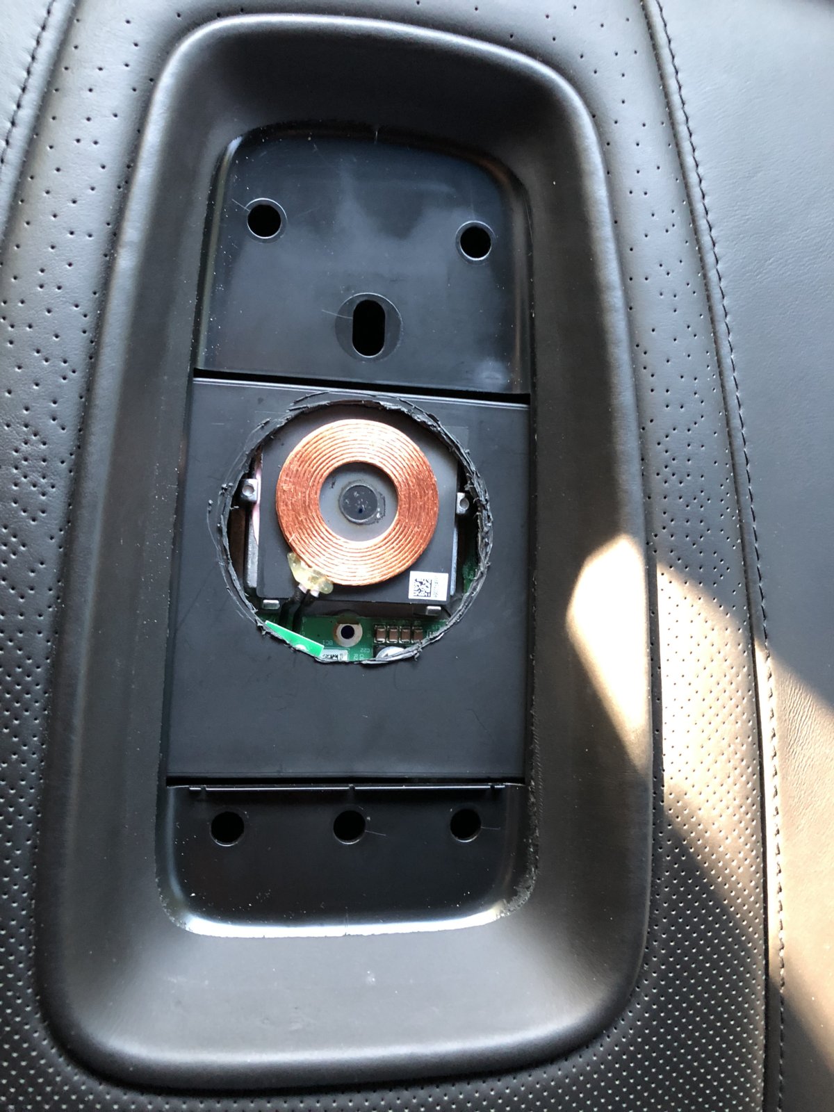

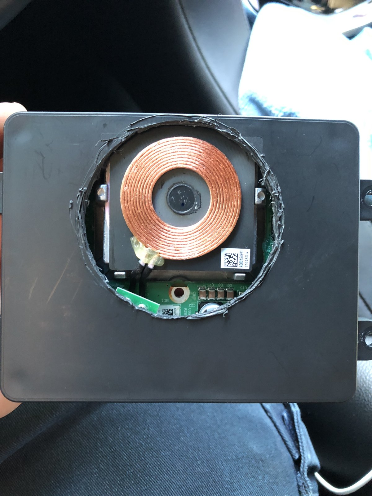

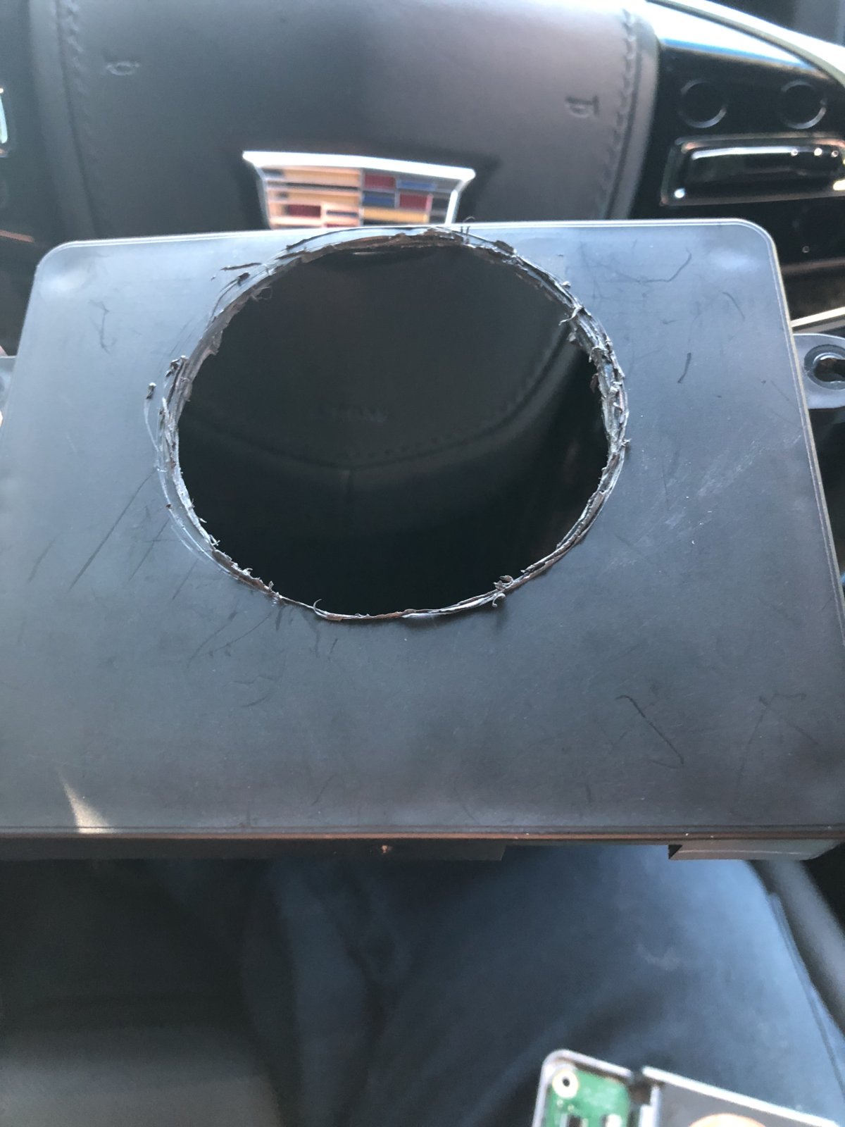

I pulled the magnet and the over current protection circuit. Then took a hole saw to the cover of the wireless charger before I reinstalled it. Put the rubber mat back down and it works mint!
View attachment 202545 View attachment 202546 View attachment 202547 View attachment 202548
