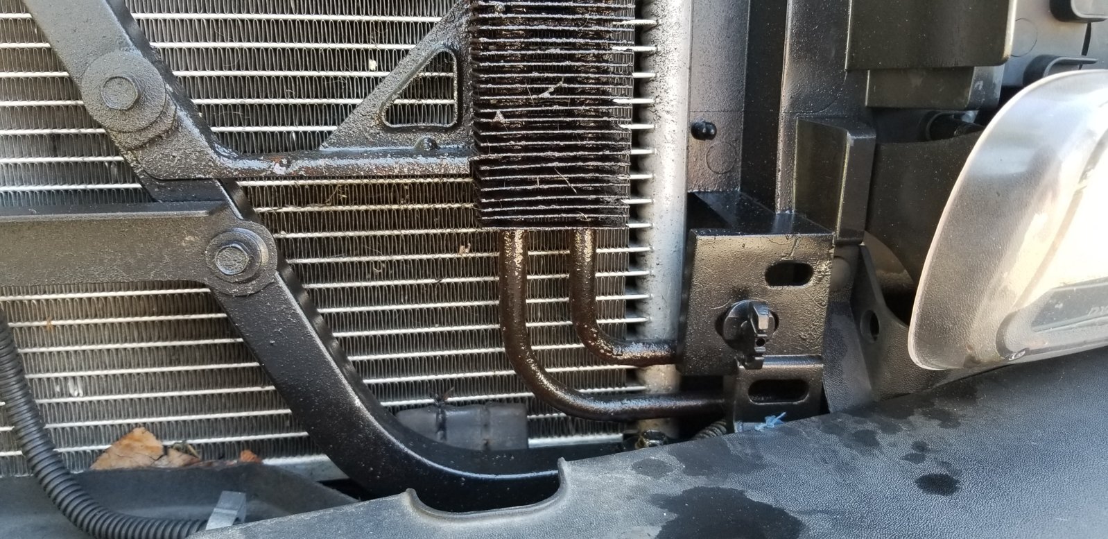

p/s fluid dont burn off. so you have a leak. slow as it might be. you'll find a wet dirty greasy dirty line im sure. ( that dirty mess is the leak)
seen a few guys have the p/s cooler leak. if you got one its up front of the rad in the grill area driver side.
33,328
51,796
Yup, they're prone to leaking through the fins usually. Especially if you're in the rust belt.
Mine.
