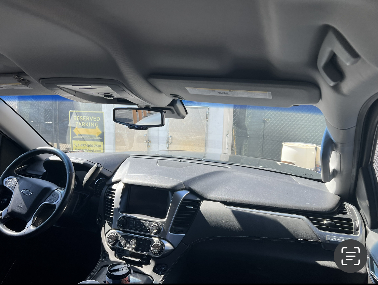

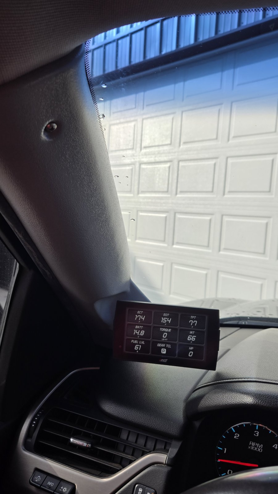

Got a a pillar gauge pod that I need to color match to the interior. My interior is that grey color. I’ve provided some pictures below. If anyone could link a spray paint can that I could buy that’s that color it’d be greatly appreciated.

3M 1080 S120 Satin White Aluminum vinyl wrap​
I found this to be the best match to our light grey/silver interiors.
I also used matte black vinyl on interior chrome trim pieces (ie: door handles, a/c vents, cup holder console covers...)
Here's a snapshot of my interior; vinyl wrap done over the OE brown faux-wood trim on my LTZ
Note: Driver's door and passenger left knee area

Back to life. Did anyone ever figure out the correct paint code for the a pillar? I need to paint an Edge mount pillar and have the same interior color.
ToysRUs
Apr 29, 2024
12
I'll just update this as I figured it out. upon pulling the a pillar there was a sticker with the color name Light Ash. And we chased down the color code of 9874.
I went to a local O'Reilly's that mixes auto body paint and they mixed a spray can for me in that color. I would say it's over a 99% match. Possibly because it's a gloss it's off a little bit. (If I had some clear matte I would have dusted it with that)
Anyhow if anybody ever is searching for that color hope this helps.
