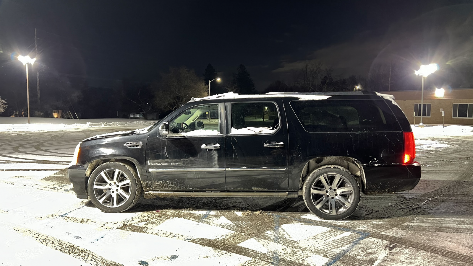

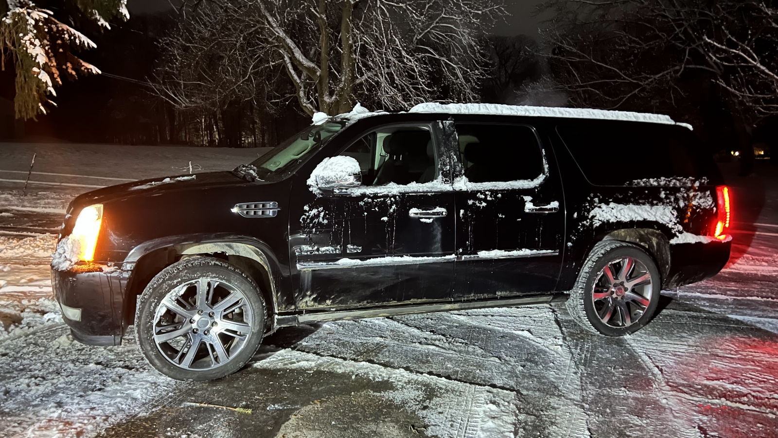

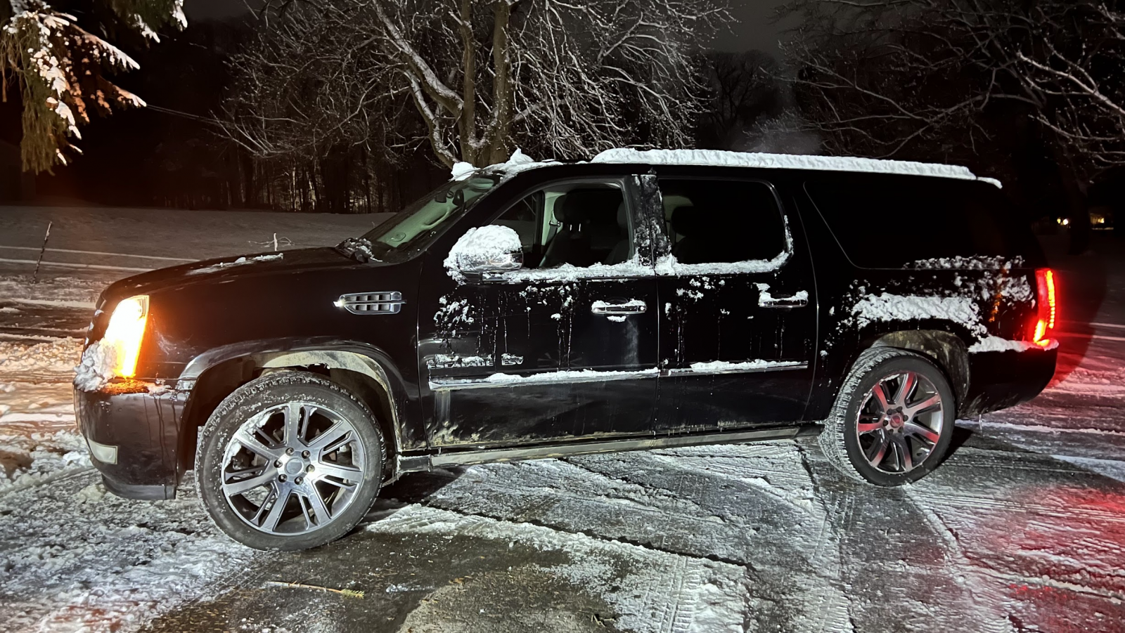

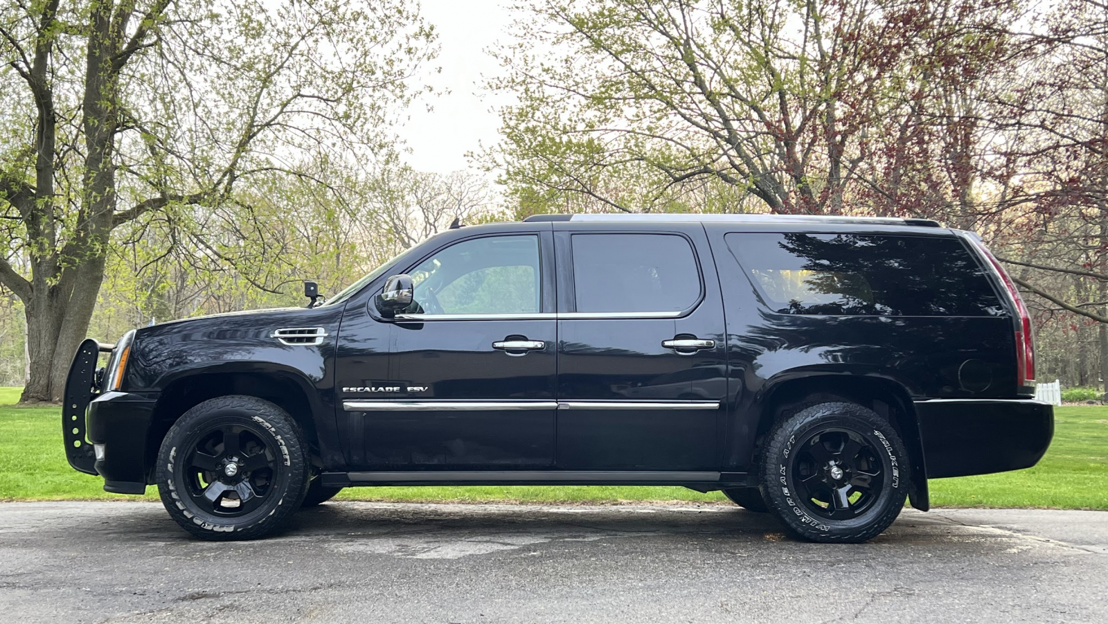

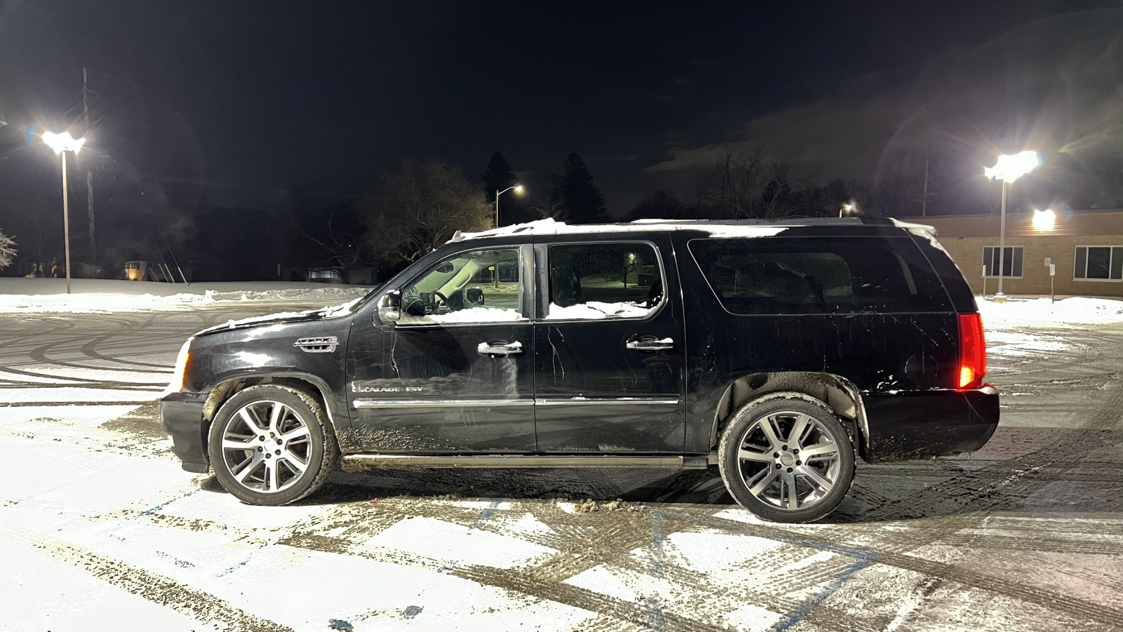

Please dont do that! Your entire front end which is every bit of 3000lbs or more is going to be suspended by 4 tiny bolts, if one fails the other will as well, if this happens at high speed do you really want to test your survival chances? Grade 9, grade 10, does not matter, they will get a tension pounding with every harsh compression and will develop cracks and eventually let go.
This is the genius repair shop that changed the struts on mine before I bought it, thought It was lowered but it turned out the strut was mounted on the bottom side.
I fixed it immedietly and this is the proper height.
Fast forward this is what it looks like bone stock with 18" wheels.
