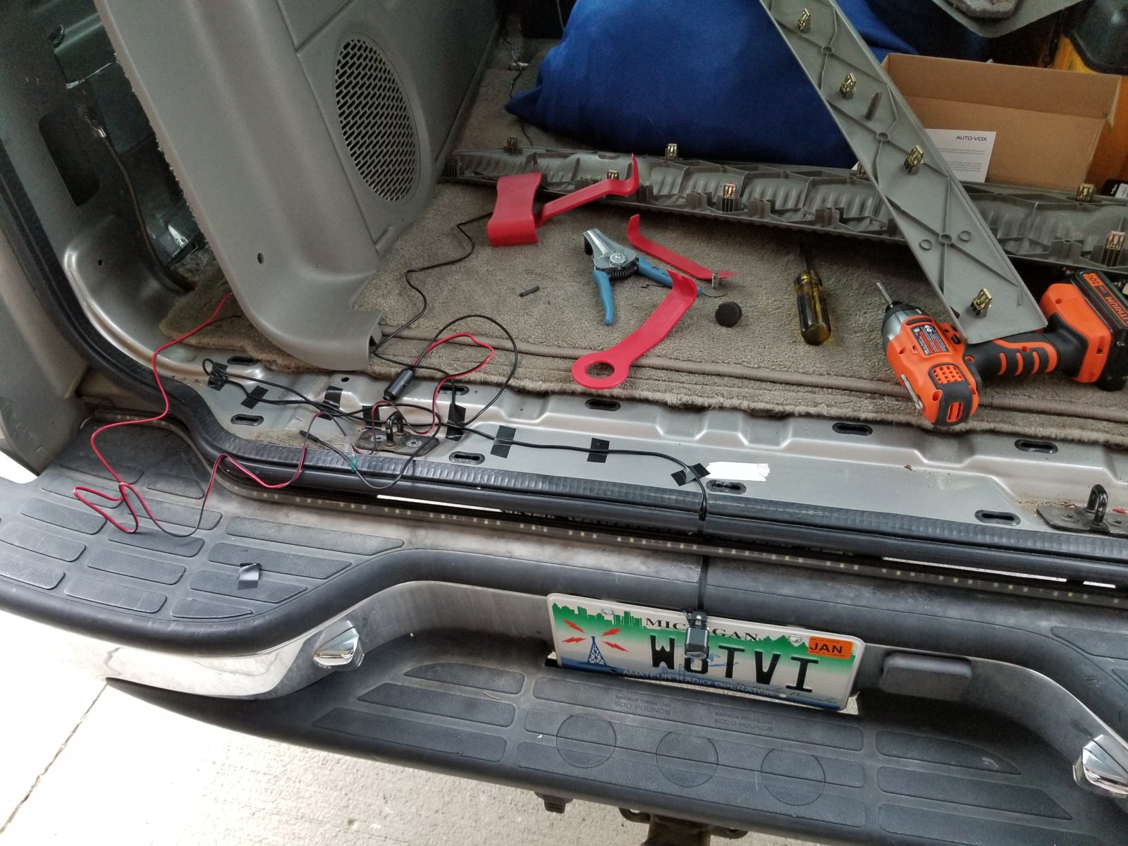

I ran mine inside without drilling any holes. I have the type that uses two bolts for the lucense plate, along with a double din. I just ran the wires from the camera going between the rubber weatherstripping to under the plastic panels on the passenger side all the way to the front, under the dash into the headunit. I spliced into the green reverse light under the dash on the driver side. No holes drilled, and my wires aren't exposed to the elements.

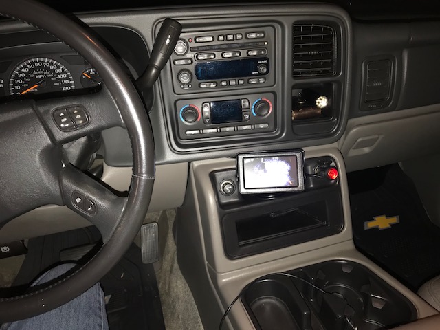

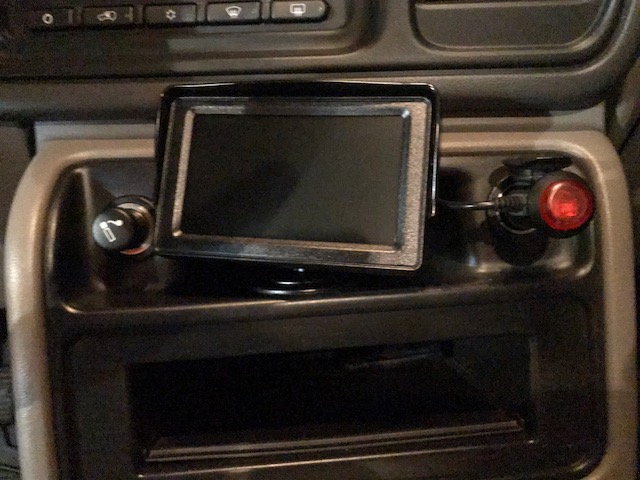

I received my new backup camera today. (Got a full refund for the other POS) Ran the wires inside under the plastic trim pieces (like you did, Tony) along the driver's side, up under the dash, and the monitor mounted nicely in the top cubby in the console. VERY clean, no wires showing.
I decided to go with the on/off switchable cigarette lighter adapter (which actually doesn't go in the cigarette lighter, it goes in the power outlet) which powers the entire system and isn't dependant on the car being in reverse, so I can turn it on any time I want.
(Kinda cool to look out the windshield to see where you are going, and look in the monitor to see where you've been! LOL!) Actually, while maneuvering in tight spots, it might be advantageous to keep it on going forward and back.

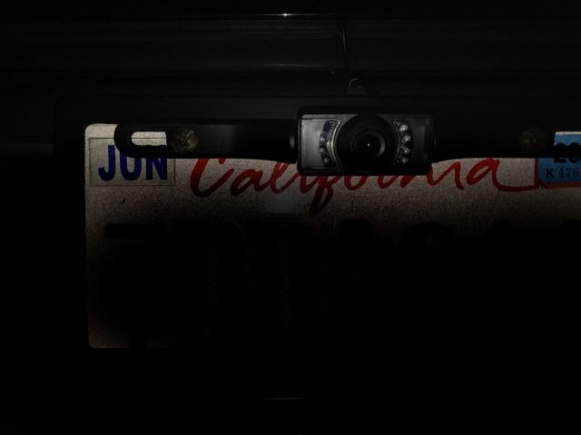

The picture is just OK, and has the 'green/yellow/red' grid lines in the pic to supposedly help with parking. We'll see. It was dark when I was done with installation, so we'll see what it looks like in the sunlight tomorrow. It has those little 'infra-red" L.E.D.s, that help the camera see in the dark. Worked pretty well tonight. I really don't need it to park, the mirrors are huge on this Tahoe, but it might come in handy for really tight parallel street parking.
It was only 27.00 shipped (Amazon prime!) and it seems like a cool little system for the $$.
(The wire showing in the bottom of the bottom pic is my phone charger)
