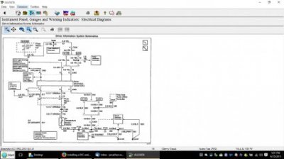

are you absolutely sure the wire colors have noyt faded to something else? i am looking at 1998-2001 astros and the colors you have still have some incorrect ones. this is a 2001 astro van:
X
xanatost
Mar 9, 2011
755
Lafayette, La.
Yep that is the colors I have. I'm not 100% sure it came out of an Astro. I did test the wiring and it all lined up to the paper I got and put it on a battery to check that it works. I think I got one of the wires I was looking for. All I need now is what wire under the dash is the class 2 serial data wire. I'm pertty sure it is one of the wires on the obd2 port. Any ideas :)
