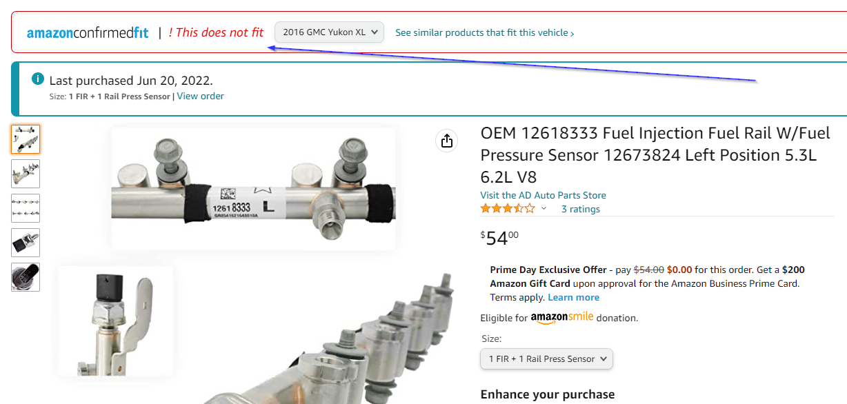

I used this drivers side fuel rail: https://smile.amazon.com/dp/B08QZXW47S?psc=1&ref=ppx_yo2ov_dt_b_product_details
If the link ever breaks: OEM 12618333 Fuel Injection Fuel Rail W/Fuel Pressure Sensor 12673824 Left Position 5.3L 6.2L V8
Despite Amazon very clearly telling me it would not work. (See attached screenshot). Fit is identical to what I removed. Fuel pressure sensor looks exactly the same - I did have to turn my connector around - but it worked just fine.
