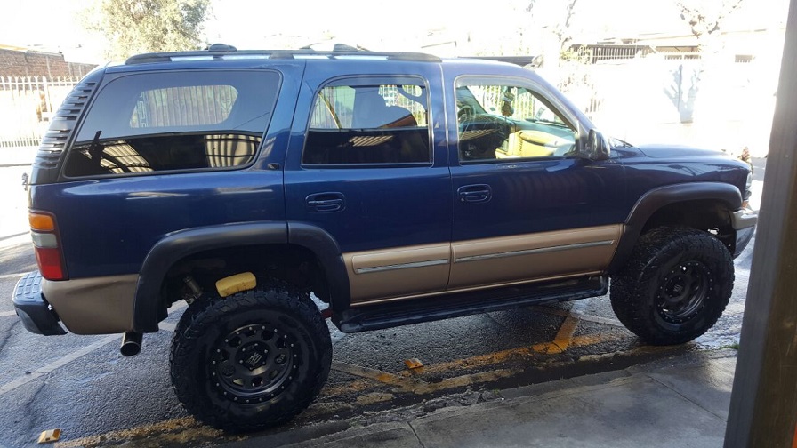

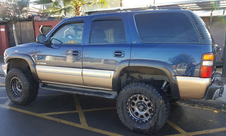

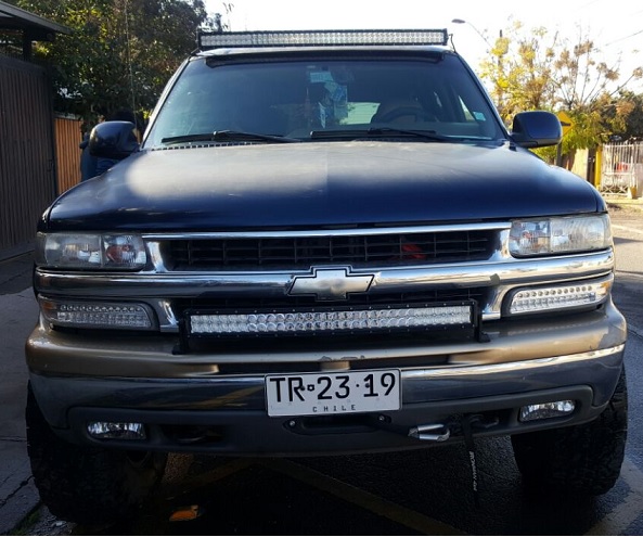

Hello friend, here I have a couple of photos, see them. It is not very well equipped, but from what I can mention it has:
iGxv05
jQcHDQ
foODnk
- K & N air intake.
- Tires and tires (315 / 70r17 BF Goodrich KO2 - XD Series 17x9 wheels).
- exhaust pipe and magnaflow muffler.
- Spohn lower control arms.
- Lift 6 "
- Fox 2.0 shock absorbers with reserve, and regulation.
- Dual direction shock absorber.
- High / low / fog lights with Led Fluxbeam OPT7.
- Led bar 50 "inches, and 32" inches.
- Rear LED lights in bumper (Tuff Stuff).
- Reprogramming of speedometer, tires, axle ratio, speed limiter and octane rating of premium benzine with Hypertech Max Energy.
- Winch Ironman 4x4 12.000 Lbs.
If I forget something I will attach it as well as more photos. I hope you like it. Regards!

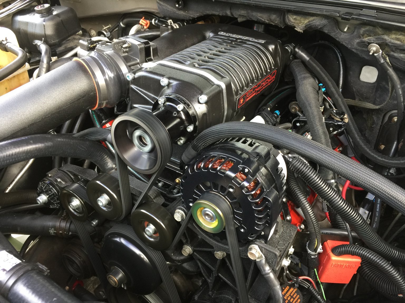

I have a camshaft ready to install, but it's not installed yet. I did install a Whipple supercharger a few weeks ago ,and installed dual valve springs, hardened pushrods, Vitron valve seals, and a rocker trunion upgrade last week, to get ready for the cam. I'm looking for horsepower as well as torque. I also have a set of longtube headers ordered.
