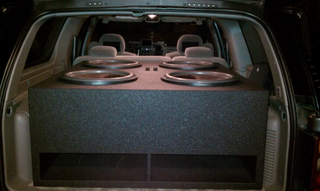

S/N wanna buy a box and 4 18's?
Double layered 3/4 MDF on all sides. Line-X on the outside. Two 5/8" all thread from top to bottom for support. Subs are HDC3 18s. Box is tuned to 37Hz

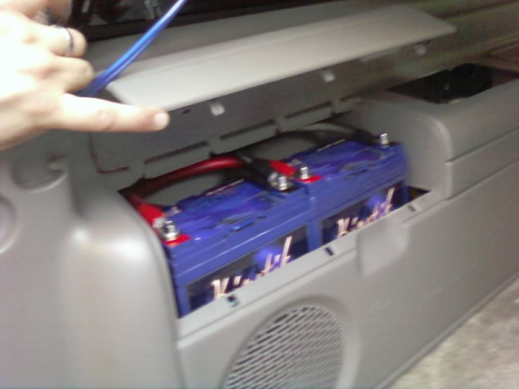

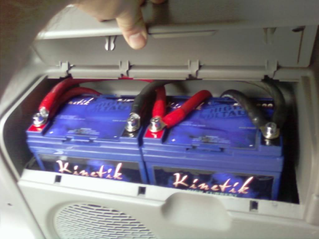

Also heres a little Idea for your spare battery. I fit two Kinetik HC800s in there.

wow shipping that whould prob coast more then my trucks worth . btw nice box and for the battery location i wish i can fit it there never thought of that but i got a 1500 i think its to big for the spot ,will look in to it tho

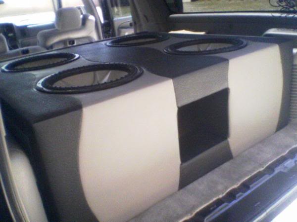

looks a lot like mine, but my port is the back...
this when i finished building it.
and this is after i got it wraped.
looks good, thats what i need to know tho befor i wrap my box, if it is correct i see alot of ppl like you have one big squar port i got 4 round its a 2 chamber box with 2 5.5'inch round ports
