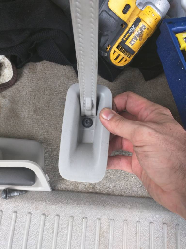

Then slowly work your way around the sides until you get to the bottom. Take your torq bit or Allen wrench and unscrew the hanging pull handle and fixed pull handle. Firmly pull on them and they should pop right out.

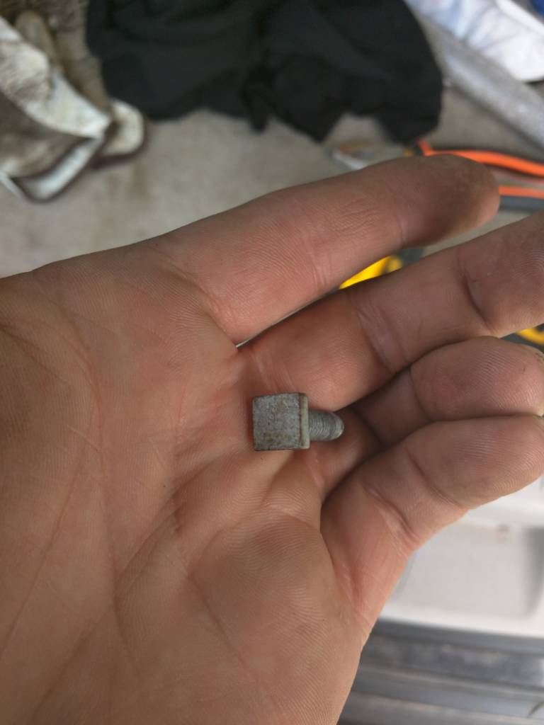

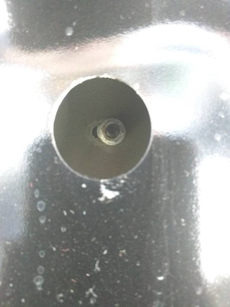

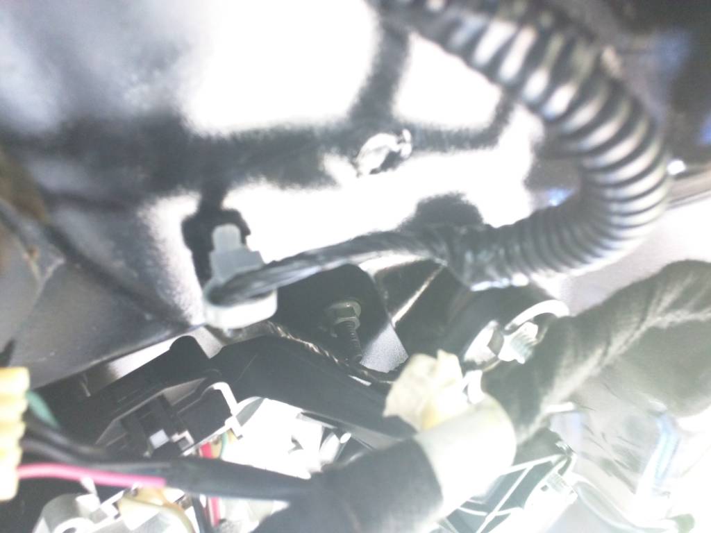

Next you will need to look for the holes that have the screws that lock into the plastic tabs on the applique. One of the screws is located behind the rear wiper motor and is a pita to get to. You can either remove it or use a 10mm wrench and pliers and unscrew them that way. There is also the two plastic pushtabs that are on the side as well.
Push the tabs out after you have unscrewed the nuts from the bolts.
Unplug your wiring and the applique should come off or out easily after that. If possible, have someone help so you don't damage it or scratch any other part of the tailgate.
Take the new applique and put the wiring back through the hole and feed it through it's previous placement. All you need to do is locate the holes and match them up with the plastic pushpins on the top and the metal screws in the middle and give it a push. The pushpins should hold it snug while you grab the nuts and put them back on the screws. Plug in you wiring and push pushpins back in place to hold it.

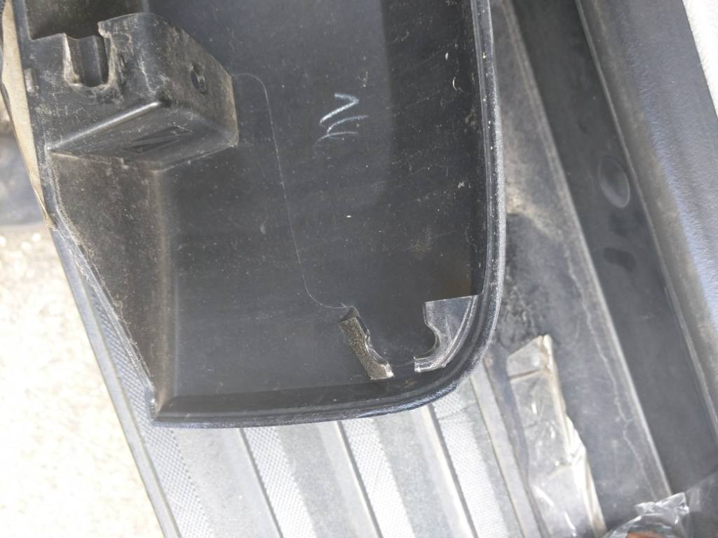

Check your plastic panel to make sure all of the pushpins are in place and reassemble in whatever way you want. I started at the bottom and worked my way up. It was a little annoying to find the pushpins holes and be careful to not break them off (i did on one of them). After that, put your bottom handle and middle grab handle back in. Then push the top trim back in place and you should be finished.

An extra tip as Im sure you know - the threadlock on those bolts is extremely tough. IF you have a small butane torch, hit the nut / bolt for about 3 seconds before taking the 10mm off. It will prevent that T bolt from spinning / tearing up the plastic on the applique 9 times out of 10. Makes reassembly SO much faster since you wont have to repair the plastic applique.
