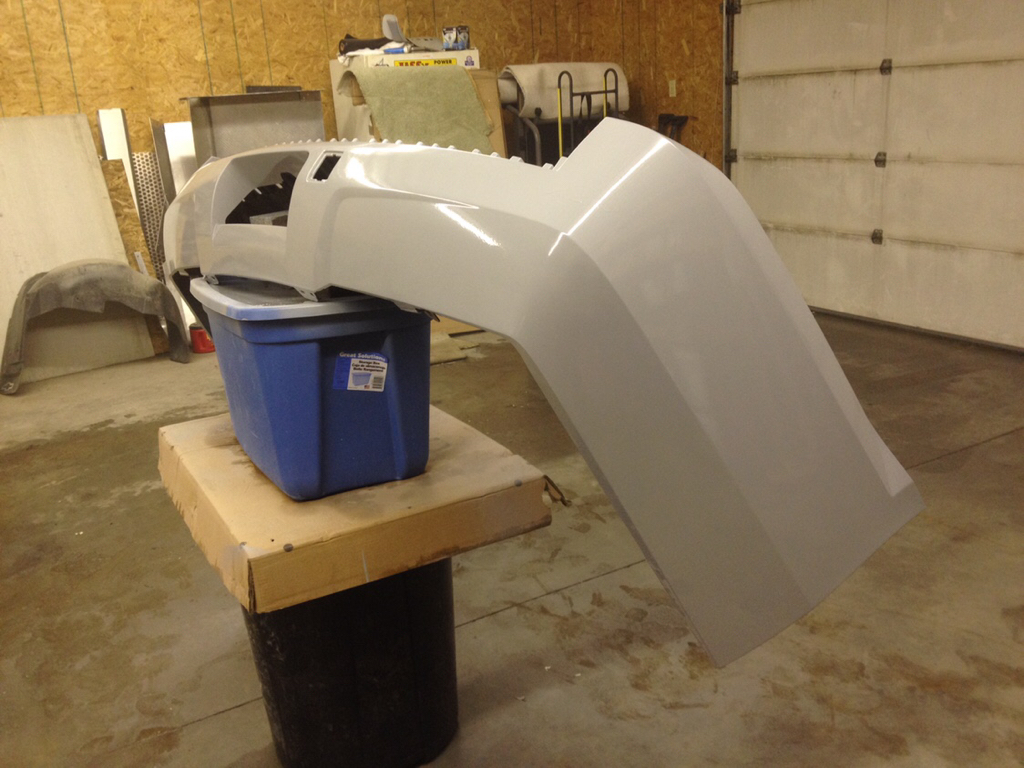

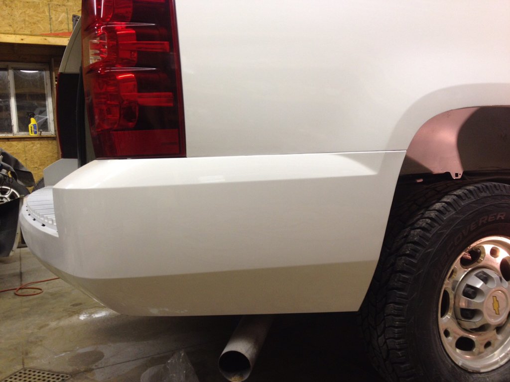

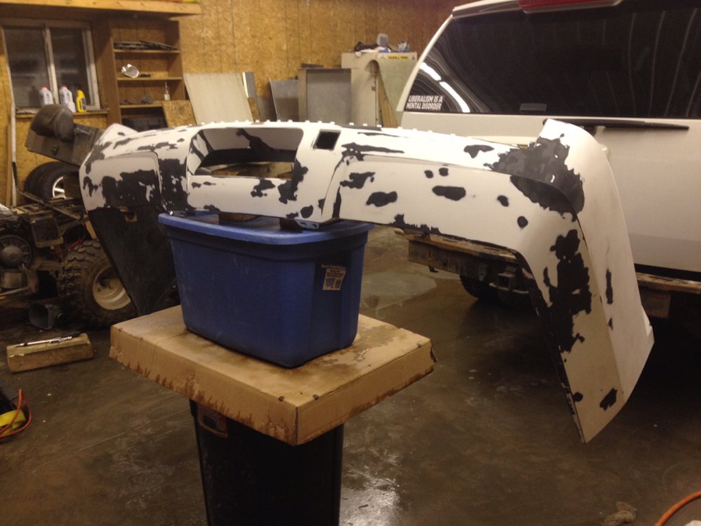

I’m not trying to threadcrap here but it takes 5 minutes to pull off the front bumper cover-grille assembly. Throw it on a dolly, clean it, wax-grease wipe, go to town with a DA sander, fill in the scrapes and gouges, urethane 2k primer, sand, wipe it down, prime, base coat, clear, DONE. Total materials cost is about $60.
Like four hours of actual work, not counting drying time. I’ve done bumpers on these trucks before. Serious consider doing it yourself or with a friend their knows what to do. Save a TON of money! Shit if you were near me (and I still owned my old house) I’d do it for a few cases of Busch Light.
Rear bumper project:

I can see the difference in color there so how are you going to blend it?

There should be ZERO difference as I sprayed color on the whole right rear side for that specific project :p
Note that it isn’t rare at all for factory bumper covers to not match the metal surfaces around it. Factory paint jobs aren’t all that. Orange peel is horrible on a lot of trunks and tailgates.

You guys are quite dramatic. I didn’t insinuate that you can go to your local Auto Value and get everything for $60. I mentioned “$60 in materials”.
I buy primer (urethane and epoxy) and clear by the gallon. Only ounces are needed to cover a bumper cover. I buy paint based on the job. My Auto Value has PPG, Nason, and two low tier brands. I only need ounces of color (quart or pint) plus ounces of reducer. I only need ounces of clear and the hardener. I buy sanding discs in rolls of 25. Etc etc etc.
I can EASILY spray a bumper for $60 worth of material.
Find it for sale and stock up on stuff. Buy the good pourer/mixer thingy for the gallon jugs of primer and give it a spin every once and while. Keep it in the basement so it keeps.

Fine - it would take $50 in materials LOL
Front and rear are not that different in area to the point it would substantially alter the project cost.
If you don’t have a decent compressor or spray gun setup, checkout Spraymax 2K primer and 2K clear from R&E Paint Supply. They also custom mix OEM colors. I’ve used it before for small jobs (a lot more recently since I moved back into a neighborhood).
