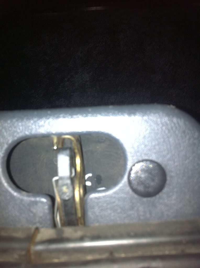

i went to close it and bam!! barely missed my face when it bounced back up. Don't know what happened. Is it just stuck or?? I was only out there around 10 minutes since its pouring rain. The black part won't come down.

Did you figure it out? Looks like the latch is already in the locked position. Might want to push the button then pull it out to unlatch it.

I agree with the others. I would spray some WD40 on it to get any rust and particles out of there, let it dry, and follow it up with a light coat of silicone spray to keep it lubed.

thats what i was trying last night, pushing it in and trying to pull it out. ill try the wd40.
---------- Post added at 11:34 AM ---------- Previous post was at 11:03 AM ----------
Ok so i got it to come down but now it looks like it slid foward and isn't where its supposed to be. it still won't close. :(

I took apart the back panel. Filled it with 6 cubic feet of foam. Removed the motor because I wanted the windshield wiper on the outside so I wouldn't have to change looks and tinkered with that latch. It's fun to mess with. The mechanics to it are simple once you have access to them. Fairly simple to remove the back panel. Ask questions if you need help. :) Mine did that too. Just push the button. lol

Thanks, i locked and unlocked many times, then just slammed it with frustration and voila!! :Plugged:
