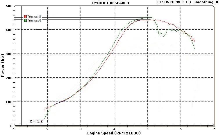

i just got back from dyno :p i love my numbers haha
check it out
dyno pull #1 = hp 437 on 87
dyno pull #2 = HP 459 on 91
-stroker 383 with forged internals (10.5:1)
-high flow CSFI Vortec Spider
-full blown motors twin fuel pump set up
- 2 X 255 fuel pumps (walbro pumps)
-comp cams mild street cam
-CFM-Tech Ported Throttle Body
-CFM-Tech High Flow Throttle Blade
-ported heads
-2.5 inch cross over pipe
-hollowed out cats
-gasket matched exhaust manifolds
-4 inch aluminum intake
-MSD ignition system (msd 6AL)
-MSD distributor
-MSD 65,000 volt ignition coil
-MSD 9 mm plug wire
-E3 diamond fire plugs
and just to back it up. (2nd gear pull)

my 3rd and 4th clutch packs were destroyed. but yeah i love the numbers. haha he said if i REALLY wanna get some power. let him build my tranny and do a full dyno tune and timing set up. for 5k total i think i will buy a new tranny and get a black bear tune for cheaper

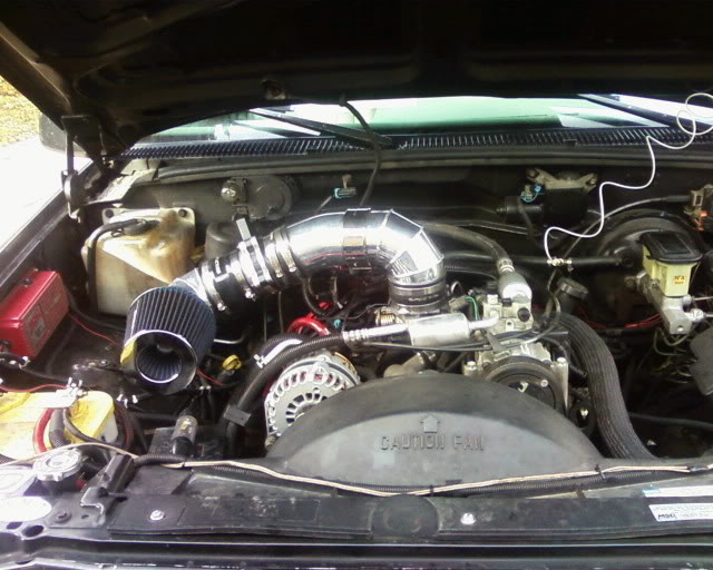

Thats A healthy small block!
RwTQ ???
So your trans is bad?
If so youve got power on the table.
How bout a pic of your engine.

yup he wanted 5 grand for a new tranny and a tune. i can get a monster tranny for about 1500 and a bb tune for about 350. so i told him no on that.
my rwtd was 501 on 91, i will see if he can send me the dyno graph of the torque curve. he might need me to make another pull :/
she is a little dirty but at this point this is the best i have right now

Don't forget to minus the 20% for the DynoJet factor. Not bad though!
EDIT- looks like you have some issues in your HP/TQ bands, did they give you any other print outs. Are you sure it was 501TQ? You should be close to if not over 500HP if that is the case.

true that he is lol but i cant get a really accurate dyno pull until i get that tranny fixed, if i go WOT in 2nd gear it pops out into first :/ so that pull was made in first and i tryed in 2nd but it didn't work :( and it slips

If you are doing a dyno pull in 1st gear on a 4L60e, I think you have to divide the results by the gear ratio, or 3.06 :1
The dyno's are expecting a pull in 3rd gear or 1 ro 1 ratio.
If you did pull in 2nd gear, divide by 1.65
They also generally track torque along with hp. 5200 rpm's is where they should cross.
Sounds like you are having fun though. :)

Transmission gear is irrelevant, as there is no such thing as a 1 to 1 ratio. You still have gearing occurring at the differential as well as the tire diameter to roller diameter. The tach reference must be established, either via induction pickup (dyno then computes hp based on roller speed relative to engine speed) or derived via tire height at xx rpm.
Dynojet operators tend to use 3rd gear because it allows a much, much slower ramp rate on an inertia dyno than 2nd gear would. On a loaded dyno, it does not make any difference. I use 3rd gear (or 4th on a manual) only when the tractive effort (torque multiplied by gearing) is high enough that it wants to climb off of the rollers.

IF I'm so wrong, do tell me how, mathematically, don't just spout about how things are done this way because that's the way they've always been done. By that logic, we should still be sacrificing virgins to appease the Gods.
Dyno development of tunes is an integral portion of my business and I have tuned vehicles in second, third and fourth gear with comparable results.
Now, with this DynoJet dyno, chances are you will see differing numbers because of the lack of capabilities of such a simplistic unit, but it has nothing to do with the gearing of the transmission, it's entirely due to the rate of acceleration of the roller. Strap it down to a dyno dynamics or mainline, set the engine ramp rate to an equivalent value for both 2nd and 3rd gear, you'll see comparable results. Tractive effort (force applied at the tire surface) will be significantly different between the runs, but engine power will be comparable.
Here's some more reading material as well:
http://www.factorypro.com/magazine/dynojet_dyno_inflated_hp_reason.html

Actually, I do tune in 2nd gear at WOT on all trucks under 450rwhp (due to tendency to climb off of the rollers). Running an extended cab pickup at 6000rpm in third gear is just asking to throw a driveshaft. If anything, I will often dial in part throttle from 1200-2400rpm in 3rd or fourth to reduce the tractive effort and yield a smoother operation, then lock the torque converter and command 2nd gear for wide open throttle, running from 1500rpm-redline over a 4-5 second span of time (typically). That said, I usually don't care at all about the numbers shown, I tune til the point of optimization and focus more on any percentage change than anything else.
The DynoJet can handle first gear just fine, the problem is that since the ramp rate is not controlled (the simplistic aspect), the engine will tach out in a second or less as the roller speed needed for 5000rpm is very low. Since the dynojet "measures" power based on acceleration, this shorter pull has much lower resolution than a longer, higher gear pull, which may contribute to variance, especially if the RPM reference is taken from wheel speed at a fixed reference point.
