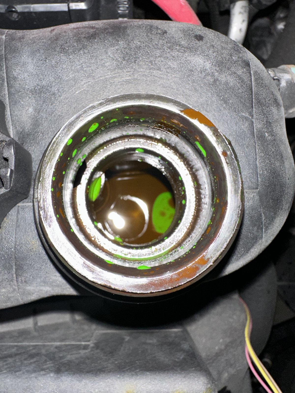

Hey Guys, I wrote last week with questions just before I would replaced my radiator. I noticed that the coolant I saw leeking was green despite coming from factory with DexCool. I had this car since new and it was NEVER SERVICED EXCEPT AT MY DEALERSHIP. Six months ago I had a leaking hose that goes to the radiator that the dealership replaced and topped off the cooling system according to the receipt I don’t know if the coolant was bastardized at this time, or at several other times that I have brought it to the dealership. But it was never serviced any place else.Tonight I took. A good look in the tank and saw a brown and green fluid mix. The truck has a heavy duty cooling system with the oil cooler built into the radiator. See attached picture. Now, is this engine oil or the mixture of DexCool and green antifreeze. Can it be anything else? I am sure I have no recourse with the dealership as they will just deny that they were the ones that did this. What should I do next ? thank you guys in advance for the help.
I want to add that this has never caused me to have any overheating problems with the coolant being in this condition. The car has no issues except a leaking radiator. I have no idea how long this issue has been going on.

That looks terrible. The orange looks rusty brown. It is also separating in there. I would confront them about it and please post here what they say. I would demand they flush it and put DexCool in it, at no cost to you. Make sure you have all your paperwork with you because I can bet you this, they will not be able to find all your visits in their computer system.

Dip some out and shake it up. If it blends and doesn't settle out, then it's probably coolant.
If it looks like your dorm room lava lamp, then you probably got oil in it.
Also, check your oil dipstick and note the level and condition. Pull the filler cap and look for snotty gunk.

Also, even if it is oil, hope not, there should not be green in there. Also again, they need to change the thermostat when they do the work.

That looks like you've got oil in your coolant likely from the separation in the radiator for the oil cooler failing. You are going to have to replace the entire system and flush the heck out of the engine and probably multiple times going forward to get all of that out. The oil will swell up the rubber in the hoses.

Green coolant isnt the end of the world, but oil in your coolant (and more importantly coolant in your oil) IS. Drain all fluids and replace radiator ASAP. I prefer external oil and ATF coolers for this reason. Running like this will kill the crank and rod bearings REALLY quick.
