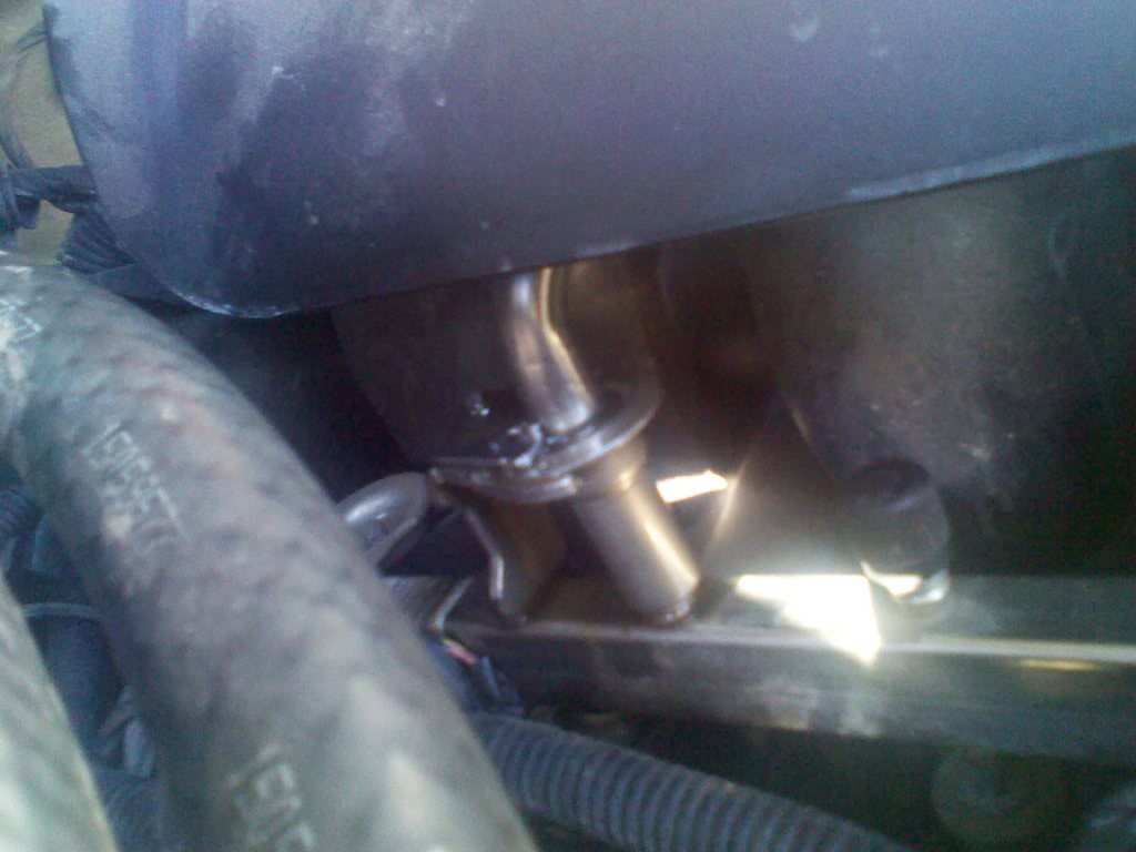

Hey guys, i been having a small leak on the passanger side fuelrail, im not sure if this is normal but it got me conserned.:emotions122:
Here's a pic of were the leak is, before i start it

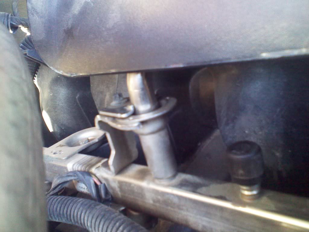

and here's after a 5 min idle
any info on how to fix it??

Looks like you may have a bad O-ring where the cross-over connects to the rail...
Take the cover off and you'll see where it connects on both side..disconnect from both sides and replace both rings and replace cross-over.. :)

Put some oil or even Vaseline on the O-rings before you reinstall it so they dont get damaged.
