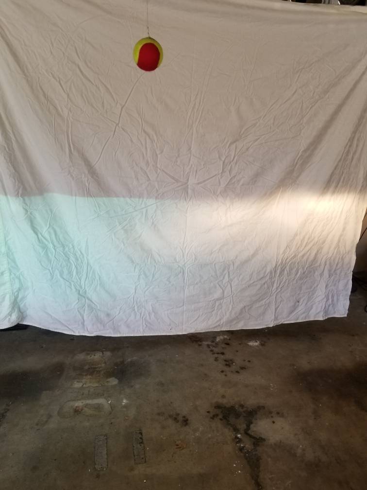

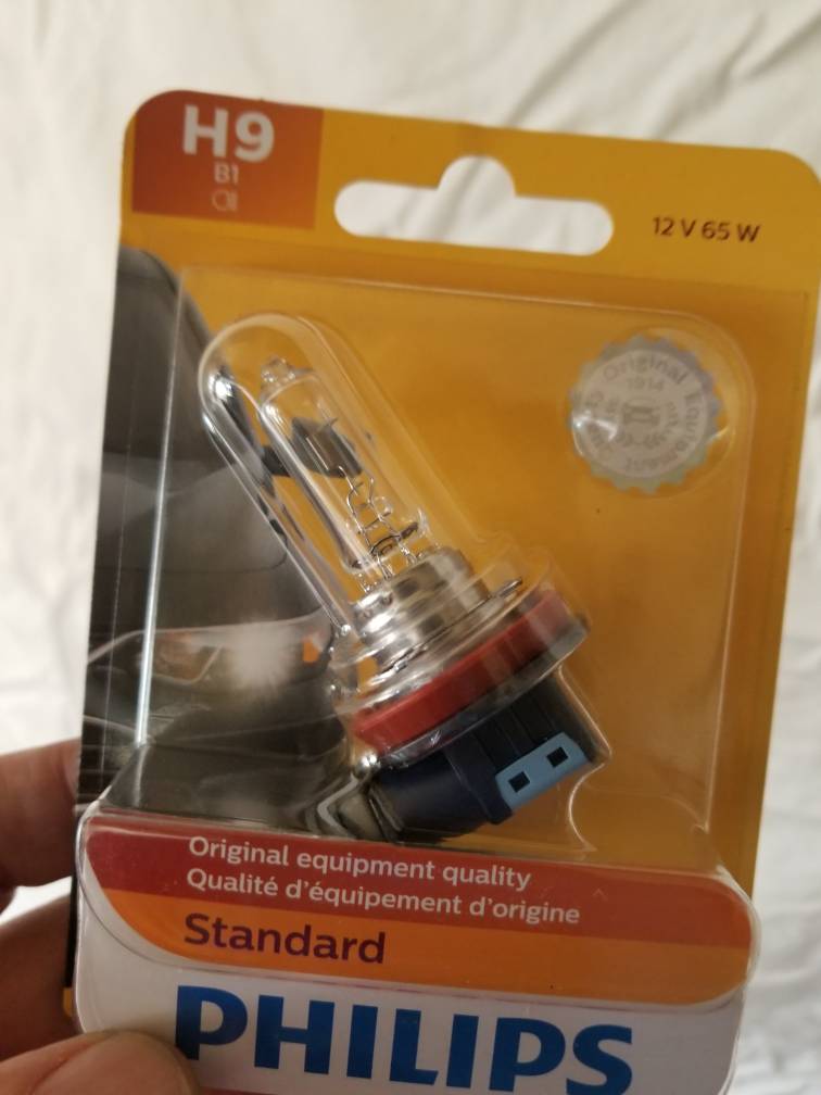

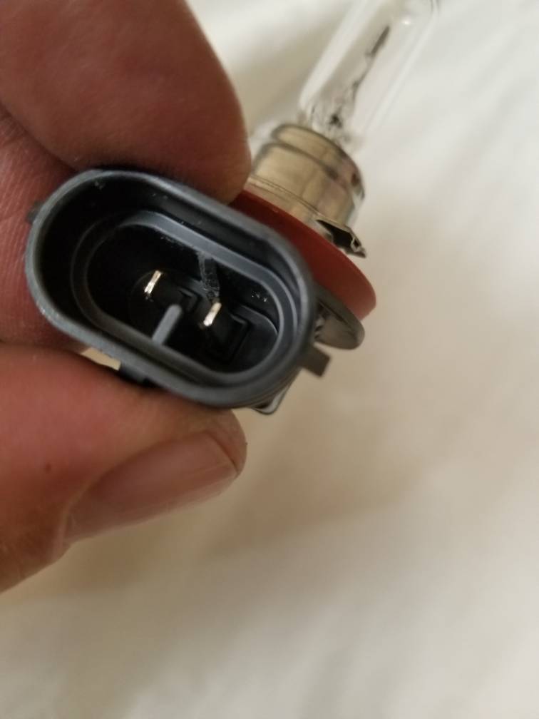

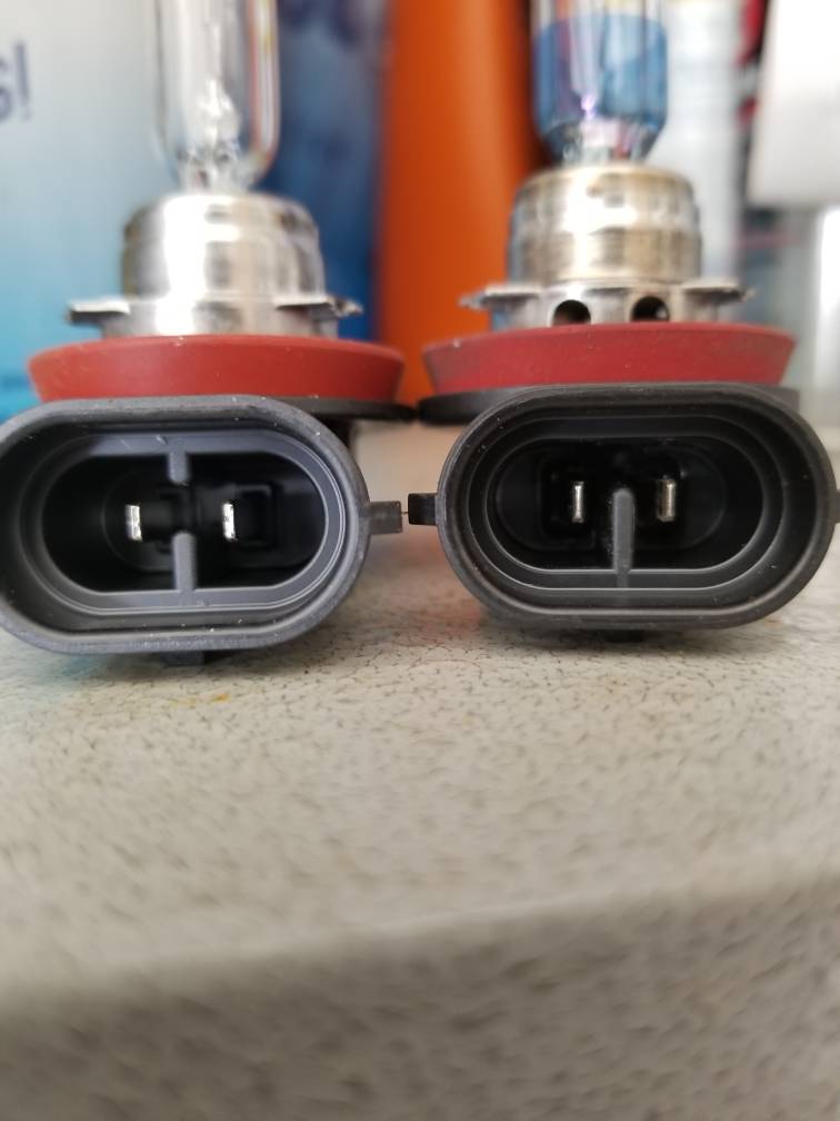

So having gone the Spyder route the last few years, I just got sick of the poor visibility in rain. I picked up some chromed OEM type assemblys, and threw in some H9 bulbs instead of H11 (a trick we used on wifes old Traverse that made huge difference). Kicks ass in these too. I have included shots of h9 vs hid in spyder projector, h9 vs h11, 2 h9, the difference in bulbs (h9 has extra tab you got to shave off), and image of $5 h9 package. Forget silverstars - just put in H9s...
