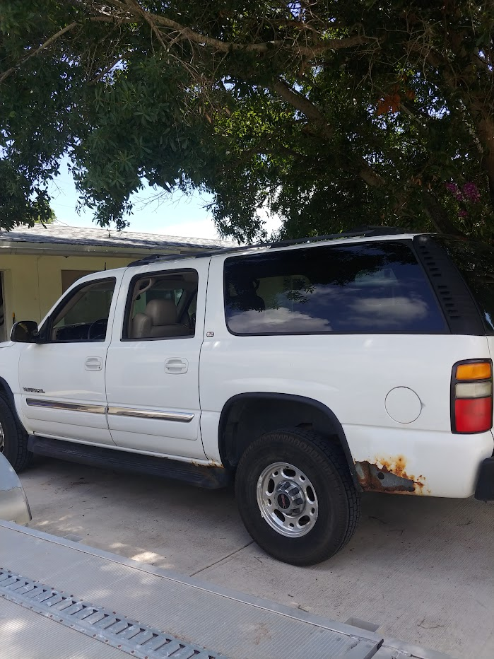

Just acquired it, bought it for Mom ten years ago. She quit driving, Sis-in-law drove it for the past 6 or so. She's fat and climbing in she tore off the driver's side A-pillar cover, no damage but there's a small harness with 4 wires; black, white, red, blue. Small gauge. They're torn free from something, I'd like to know from what; it has the overhead entertainment center, which of course I didn't test before posting but everything else works normally.
Anybody got this on top of their head?

Pics of the truck, please.
