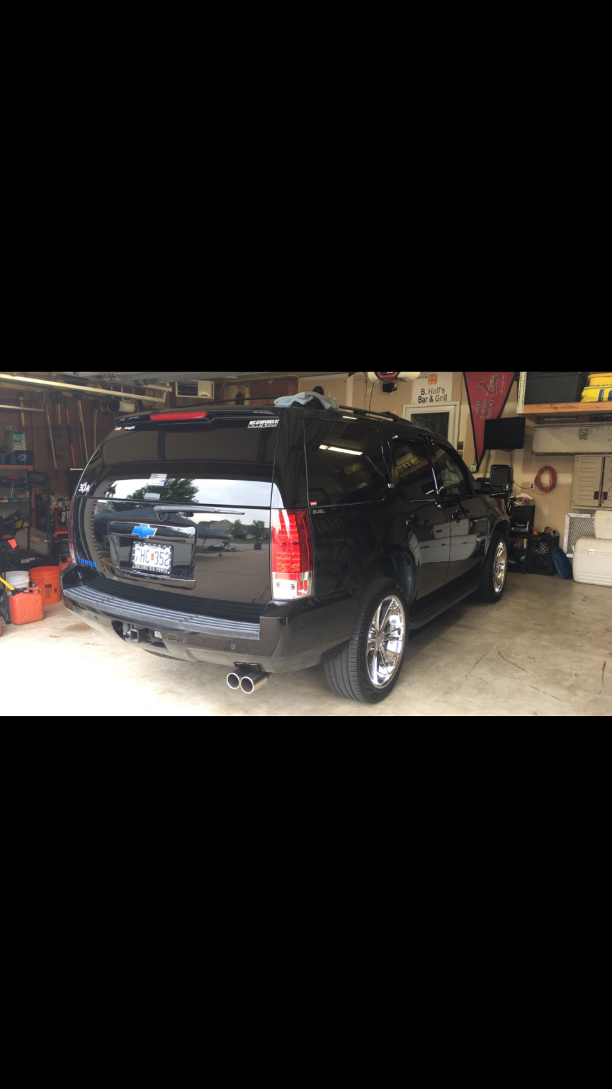

I have a 40 series on my Tahoe really nice sound drone is not as bad as everyone says I'll try to post the video later

Had a shop buy the muffler and exhaust tip. Redid a lot of the piping $224 out of the door
